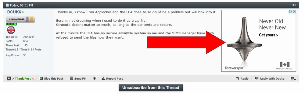

Thanks all, i know i run Applocker and the LEA does to so could be a problem but will look into it.
Sure im not dreaming when i used to do it as a zip file.
Strucute doesnt matter so much, as long as the contents are secure.
At the minute the LEA has no secure email/file system so me and the SIMS manager have both refused to send the files how they want.

All this talk of dreams has got me worried that I'm being incepted.
