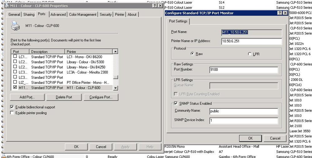

We have 4 x Samsung CLP-600 printers in the school. Every single one has the same problem, so i dont think its a hardware problem.
When somebody tries to print a webpage it crashes the print spooler, the job que just builds up and the only way to resolve this is to restart the printer spooler service.... (not v good when admin have que`s waiting to print on other printers)
Has anyone seem anything like this before? All other 35 printers are fine?
Speaking to samsung was like trying to speak to a brick wall!!!
I have the latest drivers from the samsung website, and the printer is setup as in the pic below...
The one way that i can enable them to print kind of ok, is if i select "Print Directly to the printer" instead of to the spooler. This is no good as they are then unmanaged and large jobs seem to fail.
Its driving me nuts !!!! Pls help, Any ideas ??

To install the printer on the server, i simply:
1) Add printer
2) select "Local printer attached to this computer"
3) Create a new port, called clp-600_xxx using the printers IP
4) Add the driver
5) Fill in details and share name
With one of the printers I have just tried using the disk that came with the printer, it set the printer up, but i then also got all the junk that it installed with it. Does this sound right method?

solution that seems to work... will get the staff to test tmrw...
Bi Directional - off
Advanced printing features - off
start printing after last page is spooled - on

Hi, Just stumbled accross this thread as i have been plagued by the same problem with a CLP 600 for a couple of months!
tried everything suggested here without success and was contemplating using it as a crash test dummy from the 3rd floor window when i thought i'd give it one last attempt!
2Hrs later i may have a config that works!!!!
print processor - winprint RAW
Disable bi-directional comm
configure LAN port settings as LPR to queue 'lpt1'
byte counting enabled
snmp disabled
advanced printing features disabled
set spool setting to - start printing after last page spooled
Printed a flash website 150 times without it falling over! It previously failed every time!
