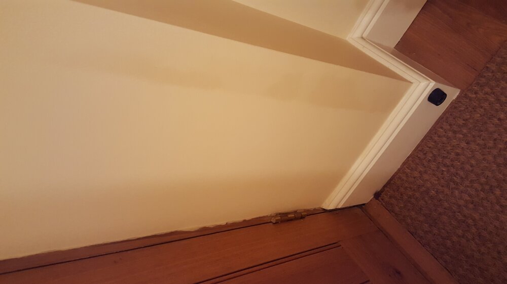

abillybob Posted December 12, 2016 Report Posted December 12, 2016 Hi Guys So after moving in we left a couple of marks on the walls while we where moving furniture in and out the house, I decided this weekend to buy some paint and fix it up a bit. I painted the bits that needed doing but the recess by the front door was pretty badly marked so I decided to paint this. It all seemed to dry and looked very good except I noticed there was part of the wall that didn't seem to dry, I left the paint to dry over the weekend and checked it this morning and it still looks damp... I'm not sure if this is actual damp or something wrong with the paint? It wasn't there before I painted it so I'm not sure if it is the paint? This picture was taken this morning 2 days after the painting: Any help or advice will be most appreciated!!
CAM Posted December 12, 2016 Report Posted December 12, 2016 Maybe just a bit discoloured, stick some more paint over it. It can be a funny substance depending what was underneath or how much paint you get on the brush.
FN-GM Posted December 12, 2016 Report Posted December 12, 2016 There is a metal thing on the corners under the plaster. So the plaster is thinner in those areas. It might be that the paint hasn't soaked into the plaster due to the layer being thinner.
abillybob Posted December 12, 2016 Author Report Posted December 12, 2016 (edited) Maybe just a bit discoloured, stick some more paint over it. It can be a funny substance depending what was underneath or how much paint you get on the brush. My main worry is that when we viewed the same bit of wall had damp on and was one of the things we told them to fix which they apparently did. It was just a standard matte white paint that was on it before but as I say that didn't show any signs of damp when the old paint was on it Sick of the issues with this house!! There is a metal thing on the corners under the plaster. So the plaster is thinner in those areas. It might be that the paint hasn't soaked into the plaster due to the layer being thinner. Good point I'm hoping this is the case the opposite side on the corner hasn't had this same problem is all. Edited December 12, 2016 by abillybob
abillybob Posted December 12, 2016 Author Report Posted December 12, 2016 Is this is solid wall or some kind of pipework boxing? If its not solid and is where pipes run up and down it may be moisture trapped inside causing potential problems. If this is so it might be an idea to go get a vent grill and then cut out a section to install a vent or fit an inspection door with the grill built in. I'm really not sure, there is a radiator near that wall so maybe?
Ausy Posted December 12, 2016 Report Posted December 12, 2016 If it was previously stained by water you would need to seal it as the old stain will come right through emulsion. You can buy a fancy product from B&Q or just use gloss paint. Wait for it to dry and then emulsion over it. Only do this if your sure its not still damp or eventually it will come through again.
caffrey Posted December 12, 2016 Report Posted December 12, 2016 Zinsser 1-2-3 is a good primer sealer
JATSO Posted December 12, 2016 Report Posted December 12, 2016 The metal on the corners will be the galvanised skim bead sometimes they rust due to underlying damp problems, and after remedial work the painter will paint gloss or a damp proof paint to prevent the damp from coming through the new coat of paint and causing it to break up. If a damp proof paint has been used before then your coat could take longer to dry and it may take a couple of extra coats to match it all up.
mikeprice Posted December 12, 2016 Report Posted December 12, 2016 If the area has been fixed then it is possible that the plaster hasn't been allowed to dry - and hence any water based paint won't dry either Glossing over it will possibly just seal the water in which ain't ideal I would leave it a few week with the nearest radiator on and see what happens not that I am an expert in any way so I could be talking BS
sippo Posted December 12, 2016 Report Posted December 12, 2016 You had issues with condensation and now damp... you need to get someone in to have a look.
elsiegee40 Posted December 12, 2016 Report Posted December 12, 2016 This might be condensation too. If there's pipework behind that (it looks like it might be boxing) then there could be condensation on the pipes
LincolnE Posted December 12, 2016 Report Posted December 12, 2016 If it was damp before when you looked at the house, do you know if they actually did anything. I've looked round houses before where it's obvious that they've bodged it by just covering it over for the viewings, hoping that it wouldn't be spotted.
Joanne Posted December 12, 2016 Report Posted December 12, 2016 I get cold spots in our conservatory and mold grows on them. I spray a light bleach solution, wipe with a sponge and then try some of the bathroom paint you can get... Dulux Bathroom Natural Calico Soft Sheen Emulsion Paint 2.5L | Departments | DIY at B&Q then paint over that with your normal paint. DAMP BE GONE!
