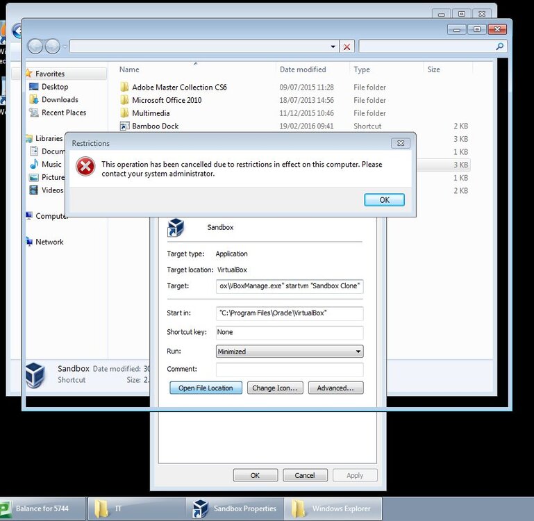

kennysarmy Posted September 27, 2016 Posted September 27, 2016 That does sound pretty interesting. We have Virtualbox installed on our client PC's with locked down settings (as per this thread) however we've found that pupils keep finding ways of gaining access to the settings. I was thinking our next step should be to implement some kind of VDI server based solution so it would be helpful if you had any guides or links to articles online which would help us create something similar to your setup? Given the requirements in the new computing curriculum this seems to be becoming a common issue. There are so many programming and development utilities they expect pupils to use (Python, PHP, Apache,etc) which really aren't suitable for running on a live network as they give the pupils access to way more than is safe to do so. It's a shame as it's causing quite a lot of friction between ourselves and the computing department. They're asking for pupils to run these apps on live network PCs with access to the internet and network shares/printers/etc but IMHO it simply isn't feasible to give them that kind of access on anything but a separate network isolated, to some degree, from the rest of the school. The problem is the overheads of running such a setup can be pretty heavy in terms of the time it takes to configure/manage it and/or the additional hardware/software required to support it. What's the worst that they can damage by gaining access to the settings?
flyinghaggis Posted September 27, 2016 Posted September 27, 2016 (edited) If they get on the Virtualbox management utility (or find a way to get Vbox to run with command switches or a specific startup script) they could re-enable the network interface on the VM or use the console to add a VM of their own making with access to the school network. This is what's making me want to move to a system where we run the VM's on a central server rather than on client machines as we'd be able lock down security settings more tightly. Edited September 27, 2016 by flyinghaggis

kennysarmy Posted September 28, 2016 Posted September 28, 2016 If they get on the Virtualbox management utility (or find a way to get Vbox to run with command switches or a specific startup script) they could re-enable the network interface on the VM or use the console to add a VM of their own making with access to the school network. This is what's making me want to move to a system where we run the VM's on a central server rather than on client machines as we'd be able lock down security settings more tightly. In case you've not come across this: Chapter9.Advanced topics Also you can lock down the setting by editing NTFS permissions on Sandbox.vbox & VirtualBox.xml so that students cannot write to them. Cheer 1
flyinghaggis Posted September 28, 2016 Posted September 28, 2016 Are the above just command line switch options or does running this command permanently change the way vboxmanage.exe launches. For example if a pupil manages to run vboxmanage.exe directly will it still give them the default range of options after running that command? We already have a customised executable to run a locked down version of the startup script but pupils have been finding ways to launch the vboxmanage.exe program directly bypassing all the security settings the script puts in place?
kennysarmy Posted September 29, 2016 Posted September 29, 2016 Are the above just command line switch options or does running this command permanently change the way vboxmanage.exe launches. For example if a pupil manages to run vboxmanage.exe directly will it still give them the default range of options after running that command? We already have a customised executable to run a locked down version of the startup script but pupils have been finding ways to launch the vboxmanage.exe program directly bypassing all the security settings the script puts in place? They change the behaviour until the relevant command is run to change it. How are they getting to vboxmanage.exe - are they able to browse the C:\ drive ??
Steve21 Posted September 29, 2016 Posted September 29, 2016 How are they getting to vboxmanage.exe - are they able to browse the C:\ drive ?? You can just run it directly via shortcut etc, or open file tab blahblah Steve
flyinghaggis Posted September 29, 2016 Posted September 29, 2016 (edited) You can just run it directly via shortcut etc, or open file tab blahblah Steve That's the problem. We hide the C: drive and have even created a custom executable to hide the scripted shortcut location and parameters but there's always an old wind9x/3.1 based program they need to run which lets them freely browse the C: drive and find out where it's installed. And if they google Virtualbox with a little bit of investigation they can (and already have) guess where it points to. It's worrying as they've set these applications as being part of the curriculum but nobody appears to have given any thought to the security implications of running development/coding apps on school networks. Most of the other local schools I've spoken to have just installed Python/EasyPHP/Vistual Studio/etc directly onto the computers and given pupils access to run them. Edited September 29, 2016 by flyinghaggis
kennysarmy Posted September 29, 2016 Posted September 29, 2016 Our students get this when they try to "Open File Location..." This is restricted via our student group policy restrictions.
