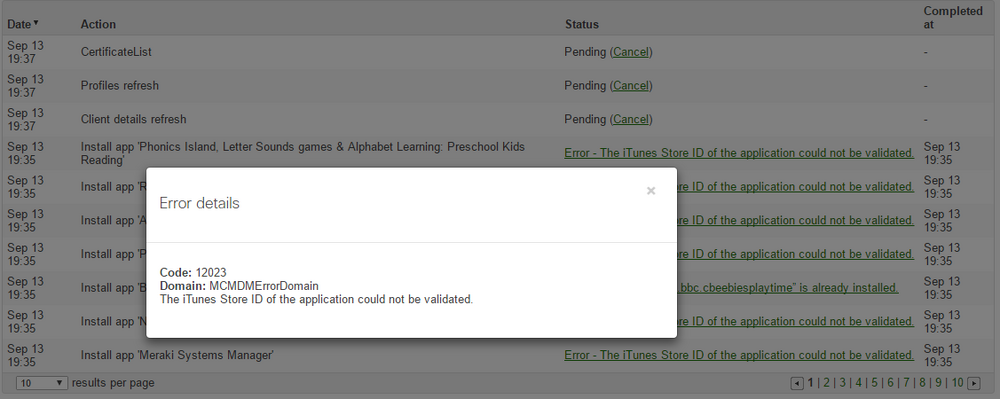

robsonma Posted September 13, 2016 Posted September 13, 2016 Hi All, I have moved to a new school and we are re-doing all of the Ipads, Set up a New Meraki account and set it up (I have done a few) all fine. Installed profile to Ipads again all fine, When I push the apps using Meraki I get the error on all the apps grrrrr anyone seen this or had same issues?
fredbayker Posted September 14, 2016 Posted September 14, 2016 The most common reason for this error is due to app licences. Have you assigned licences to your Apple IDs or devices?
datar_ Posted September 16, 2016 Posted September 16, 2016 If you have purchased your free apps on VPP, try going to Systems Manager > VPP and re-syncing your licenses. I've noticed the polling has been quite slow recently.
sarahstacey Posted September 20, 2016 Posted September 20, 2016 Hi, I am getting this same error on multiple apps, it's so frustrating. As we do have all the licenses, it seems really hit and miss as to what works and when. Have you had any luck with a solution robsonma? Thanks Sarah
