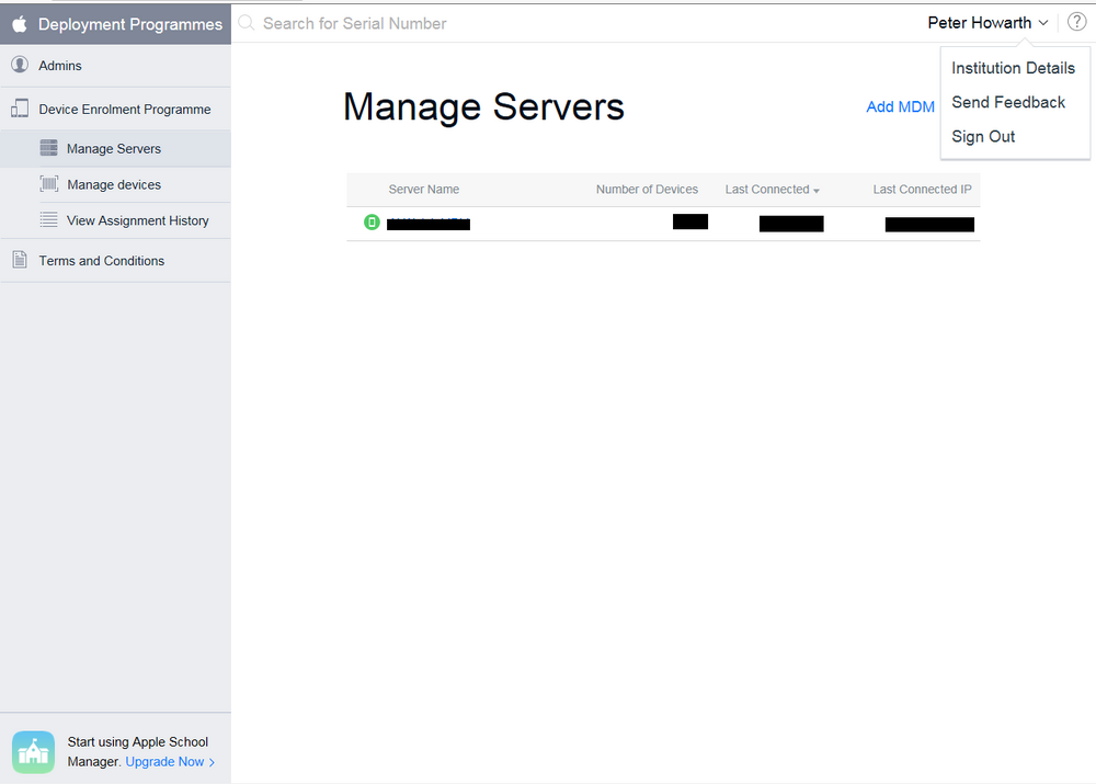

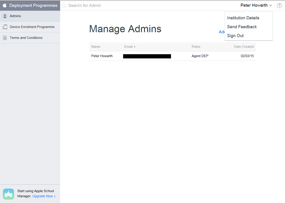

Hi Rob.
Something's amiss then.
You should have Institution Details on the top right menu, and you should have "Device Enrollment Programme" on the left menu.
See pics attached.
Is your admin role a "Agent DEP"?
Peter
Hi Rob.
See pics attached.
Peter

Peter,
Wow, yours is entirely different to mine! I had better send Apple another message. It seems as though something is messed up with mine.
