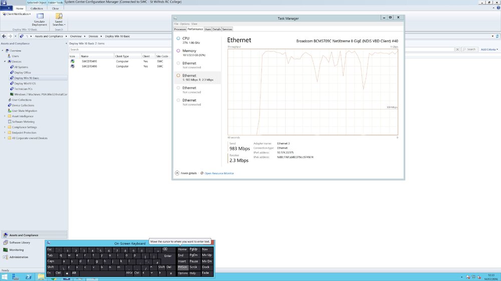

That other reg change is for the initial downloading of the boot file only. Mind after looking at it and changing some more values it was downloading the image to the local drive at 950mbps before it started deploying so not sure why i was complaining now.

See attached screenshot.
