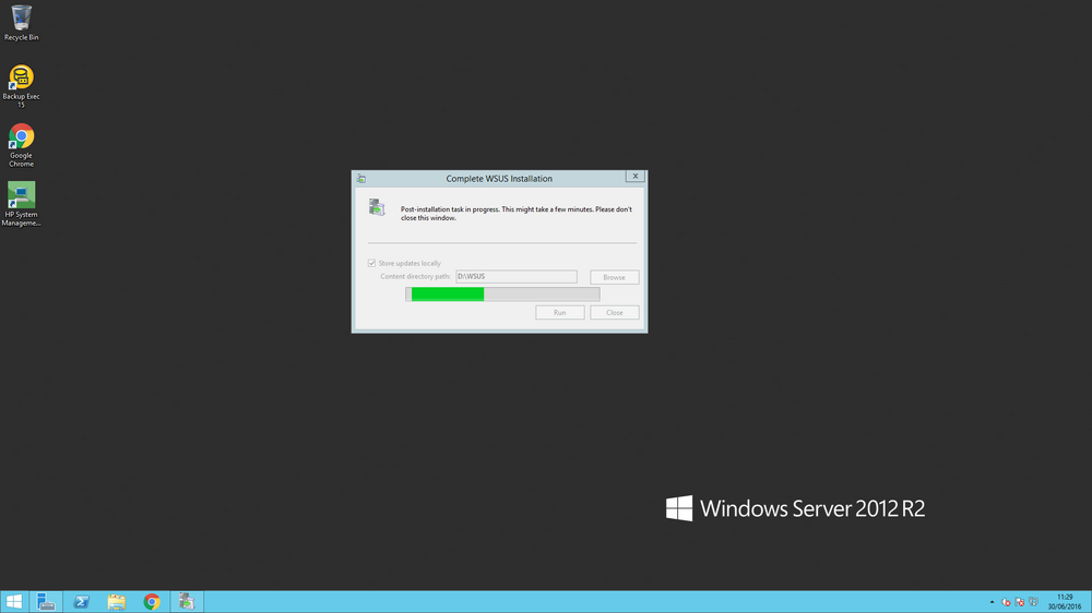

Have re-booted and attempted to open WSUS again and it seems to be stuck on this screen:
