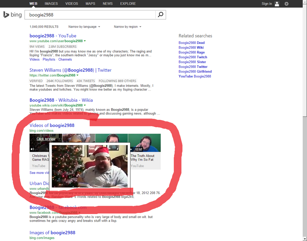

I have our provider looking into it now but came across an issue where students are able to watch youtube videos by using Bing and just mousing over the thumbnails. Not sure if this is an issue any of you guys have come across and if so what did you block?

Is that definitely when you're just hovering over the thumbnail, e.g. ytube.png?
My mistake for not reading original post ! Yes the thumbnails do show the video.
