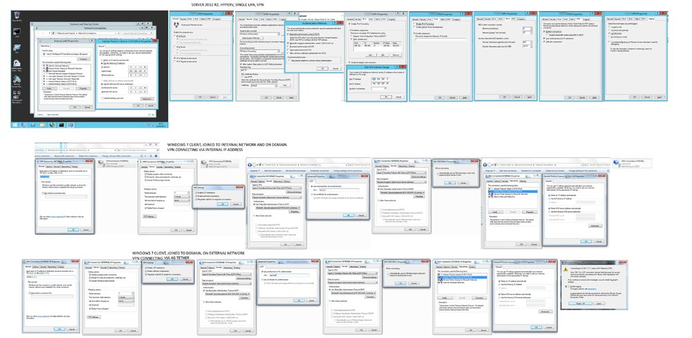

As I am getting desperate I have screenshotted the Server config, and both client configs.
I've also got the packet captures from our firewall supplier from a 4g tether test.
