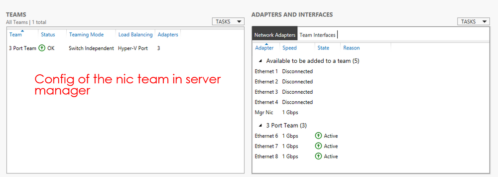

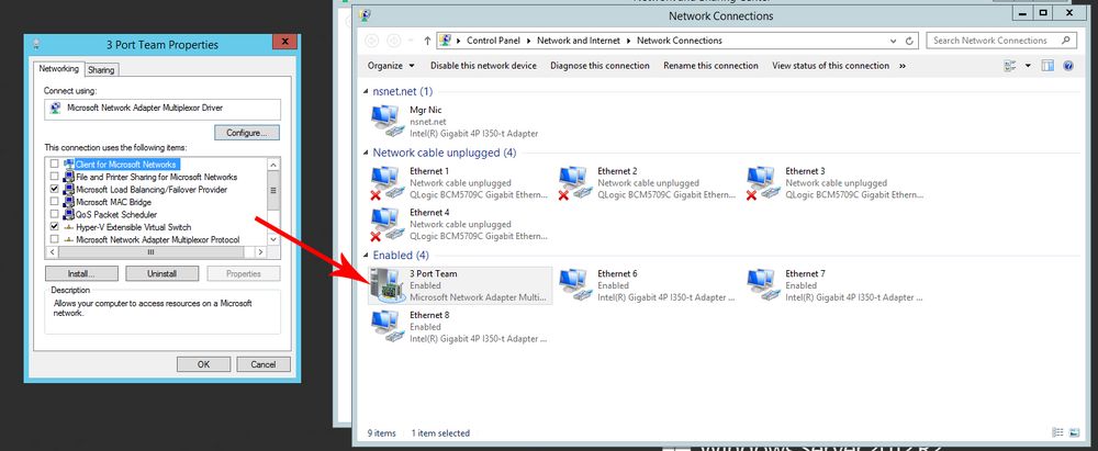

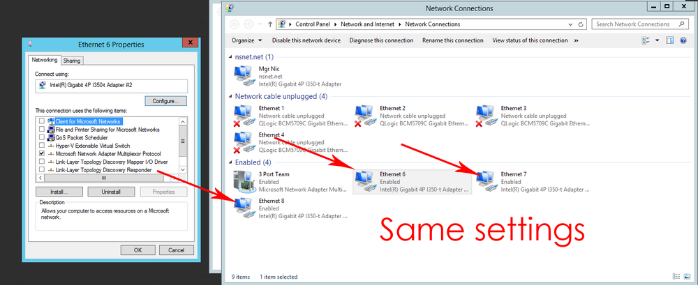

Network Manager would be useful:
How are your NICs setup, i.e. where does your hyper-v traffic go over? do you insert a tagged vlan in the VM NIC setting at all?
Hi Sorry for the late reply.
hope this helps.... just for reference, we have another hyper-v host with the same settings that works fine.

Just a thought -
On the screenshots the Intel NICs all appear to be working, whereas the Broadcom's are not. When you bought a new NIC (I'm guessing a Quad adapter), was the original also Broadcom or were they an Intel?
