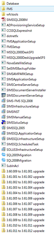

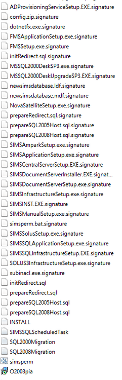

As requested - setups folder (sorted by type - sorry!):
[sNIP UPGRADE ZIPS]
Thank you for the setups folder.
I could also do with the contents of the Options folder, along with file extensions ( so I can transfer the files back into the folder)
