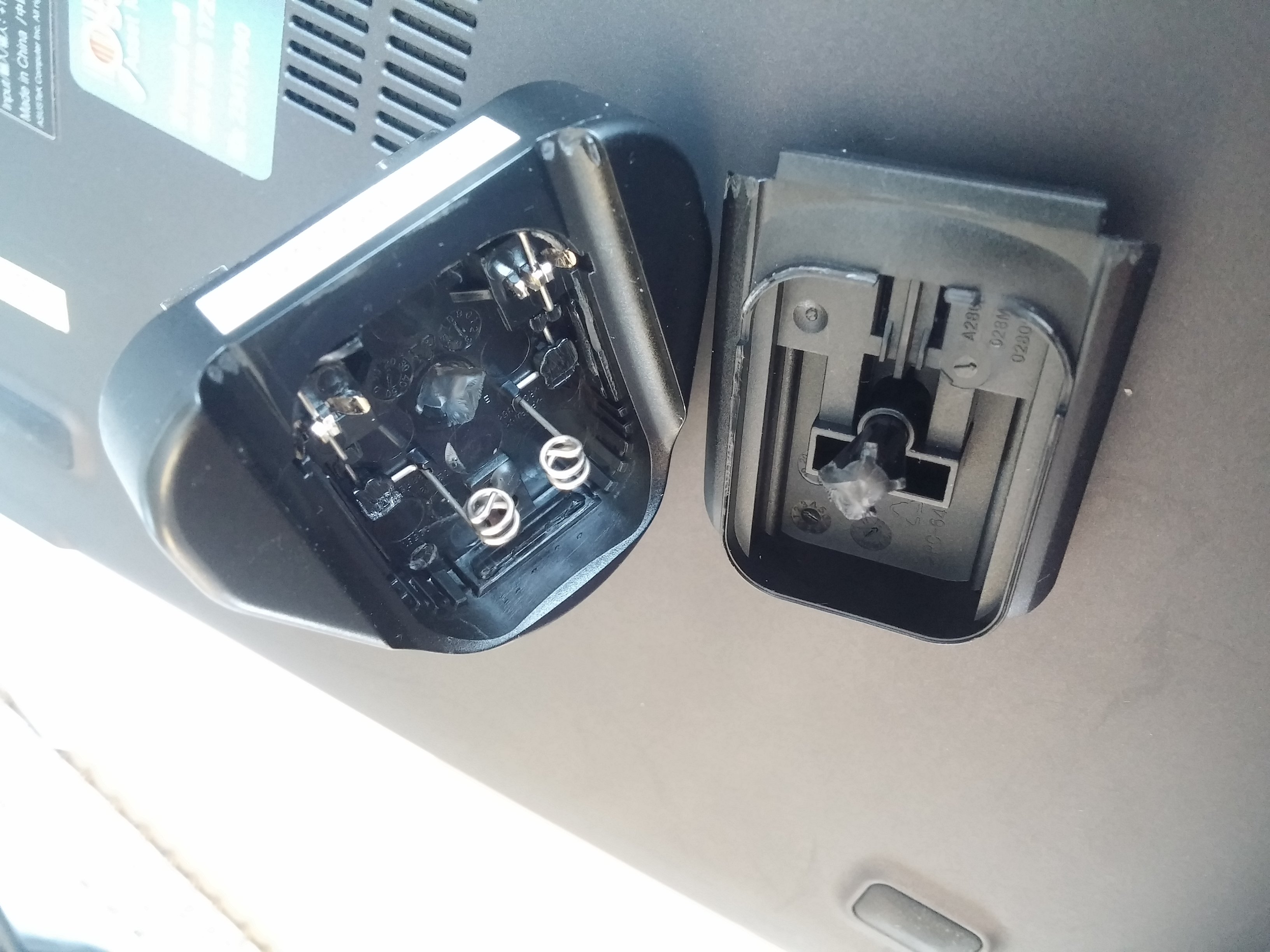

We have around 120 Asus S200e laptops, these are commonly purchased Windows 8 touchscreen laptops.
Recently a few plugs have been knocked by the users and they have fallen apart in a very scary way. I've spoken to ASUS technical support who said they couldn't really do anything, I've been passed through to the complaints department (just a form on the website) and am awaiting a response.
I'm posting this as a word of warning/caution in relation to these chargers.
Looking at the photo above you'll notice the lovely two pins connected directly to the 240v supply with no fuse in-line.
One thing I'm not sure about is whether the UK adapter part of the charger should have an CE stamp on it, I can't find one!
Any suggestions or advice would be most appreciated.
[ATTACH=CONFIG]30486[/ATTACH]

I'm fairly sure that it's illegal to supply an unfused plug in the UK - I'd give ASUS a call back and point that out! Did you buy these direct or from a third party? Whoever sold them to you may well need reporting.

Thanks for your replies, they were purchased from a large UK supplier (not fair to put their name here, yet). I've looked at some pictures online and the chargers are the usual ones, we've even ordered some spares which turned up just the same. These are the original ones that come in the Asus laptop boxes:

I've just a reply from Asus - they're saying they are not genuine adapters. After some googling I'm not sure I believe that. . . I'm going to get in contact with the supplier again, and the fire service. @DocHouse any chance you could let me know what sticker/code you have on your adapters, perhaps PM me. Maybe we had the same supplier?

May not need a fuse, but I see nothing to exclude an adaptor from safety requirements. In fact
Supply of Electrical Devices: Specified plugs, adaptors and fuse links or cartridge fuse links for specified plugs, sockets and adaptors must comply with the specified standard, see Regulation 4 and Definitions in Regulation 3. However regulation 3(3) does recognize that where compliance to a British Standard is required a standard or specification recognized in another Member State may be used provided it gives an equivalent level of safety. A notified body must approve plugs to BS1363 (standard plugs) and conversion plugs. Where the use of a notified body is required, the notified body may approve products which provide an equivalent level of safety to the specified standard.
I read it as being covered under the excluded devices. "Any plug, socket or adapter which incorporates any other electrical device (other than a fuse link, switch or indicator light).
These are of a similar design to Blackberry chargers, the main electrical part being CE marked the UK plug adapter just being a bit of plastic and metal contacts.
I really think that if this kind of adapter were illegal we'd have seen something about them by now.
Although i think it is excluded, from the amount of these type of adapters i see, surely by definition if it's not complying with standards it is illegal ?
I had one here a second ago on my desk, main electrical part CE marked, the UK plug bit isn't.
It also details in the FAQ of that pdf.
Q. Does an adapter or travel adapter need a CE mark ?
A. No - they are covered by the regulations.
We have 1200 Asus Transformers and have had many charger failures of exactly the same kind. Same story from Asus too. We went to our H&S advisers and they advised us to issue a safety notice and if we felt it serious enough, a recall. We sent warnings out to all students and parents with photos but to be honest, not many people seemed that bothered - which is even worse!
The fact that it snaps easily is poor.
The fact that is snaps off easily thus providing direct access to the 240v pins is outrageous. I would contact you're LEA legal department immediately.
I would also pull them from service immediately until the matter is resolved.
