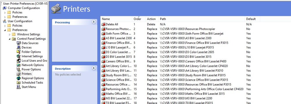

Does anyone have any advice for deploying printers?
Currently applying printer preferences is our longest hang time when a user logs in, and we're looking for a way to speed this up if at all possible.
Our printers are deployed via GP using security groups for targeting, using a user configuration to deploy the drivers.
On order 1 we have a delete all so that users don't have a printer from the other end of the school mounted by mistake, then the rest of the printers are added.
Is there a more elegant way to achieve this? I'd love to find a way to get the right printers mounted on the right machines without having to uninstall and re-install them every time a user logs in.

I would try changing replace to update (or create) on the printers, you have already removed them all, I believe with replace, even if the same user is using the same PC it will try remove the printer (even if not installed) and re-add it, hense the hang. Alternatively, could you not add the printers to specific PC OU's, so there aren't as many printers to look through to check if it should be added?

Chaning replace to update wouldn't change anything as the first thing to run is the delete all command. We already have OU's set up for the targeting of the printers.

well i suspect thats why its slow if you remove all printer drivers then reinstall several its going to take a measurable amount of time just to copy the drivers from the server to the pc and thats without installing them. You may do better off using gpp to deploy printers to pcs rather than users (using loopback so you can do it using the same settings) and kill the delete or at least do a more specific delete to only re move "wrong" printers so it doisent have to reinstall drivers every login

I know that's why its slow, what I'm trying to find is a way to avoid having to do that
but how will that cope with users logging in in different locations that have different printers? We don't want users to end up with 20 odd printers on their account
I thought about using the GPP to target computers instead of users, but assumed there was a reason why this hadn't already been done.
Does anything have to change for that or is it as it seems?

You can add to the existing Item Level Targeting to also check the OU or security group that the computer is in and assign printer based on that. This works well if you've got printers that staff should have access to in certain rooms but not pupils in that room. For any printer in a room that everyone should have then I'd go with setting up the printers through GPP on the Computer Settings side (with targeting as normal) as that will set them up at start up rather than login. You can probably just copy/paste them into other side of GPP from the current one so you just have to adjust whatever targeting you have in place.

That's brilliant I'll test that out this afternoon with a few computers.
