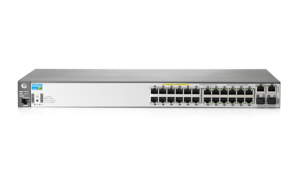

I've just setup a E2610-24-PoE ProCurve switch similar to what you describe today. Here's relevant part of the config:
vlan 1
  name "DEFAULT_VLAN"
  no untagged 1-24
  tagged 27-28,Trk1
  no ip address

This results in 1-24 having untagged Vlan 2 and tagged Vlan 3 (for phones, via LLDP). All vlans are tagged on 27-28 (SPF), 25-26 are Trunked and all Vlans are tagged down this trunk (Trk1).

Whats 27-28,Trk1 ?
I take it that ports 1-24 are any VLAN and 27-28 are management
Edited by mikkydoos
Perhaps a picture would help?
1-24 are the 100Mbit ports for edge devices, so PCs (with possibly VoIP Phones). The are untaggged on VLAN 2, with VLAN 3 tagged for voice (negotiated between the switch and a VoIP phone over LLDP).
Trk1 is a static port trunk of 25-26 (the 1GigE ports). This is my uplink to my core. (Tagged all VLANS).
27-28 are unused SPF ports. (Tagged all VLANS, but actually disabled in the config).

No two ports are in the trunk, 25 and 26. And no, VLAN 1 is only tagged on the trunk port because you don't use the default vlan for anything other than switch access. VLAN 2 is untagged on the access ports and tagged on the trunk. VLAN 3 is my voice so it's tagged everywhere. Access ports with VoIP phones negotiate with the switch to get on the Voice VLAN.
My head hurts !
Ports 25 and 26 are working together as though they were a single port - they are configured as the Trunk i.e. a way of bundling all of the vlan traffic from the core switch to this switch.
VLAN 1 (or the default) has only been tagged on the trunk because the only traffic that will be on it is the Admin user doing switch management. It won't be going out to client PC's/phones so is not needed on those ports.
VLANs 2 and 3 are assigned to every port 1 - 24 because they will be carrying traffic to client devices. VLAN 2 is untagged on these ports, therefore, the default behaviour for any device being plugged into it will be to get an IP from VLAN 2. So PC's, printers etc.
VLAN 3 is tagged on those ports meaning that the traffic will go to those ports but it isn't the default behaviour given to client devices. If however you plug a VoIP enabled phone into it, the phone has onboard software which can distinguish that there are 2 VLANs present and one of those is tagged for Voice traffic. The phone knows to then use VLAN 3 for itself and 'pass-through' the vlan 2 traffic to a PC that would connect in-line.
