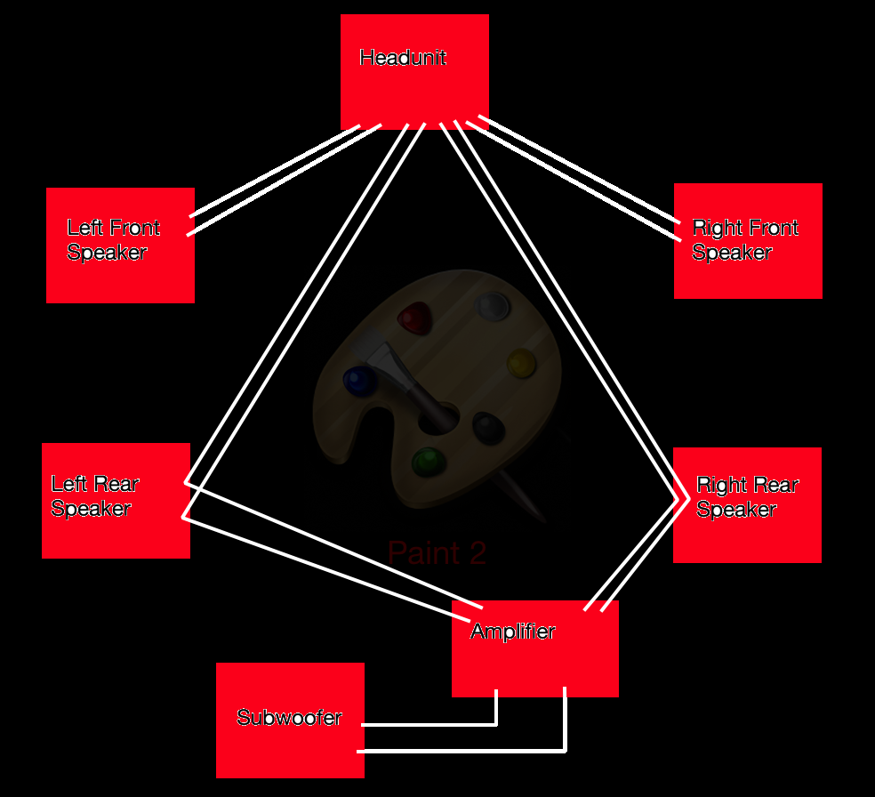

Ok so my Amplifier that came with my subwoofer has a "High Input" which basically allows me to connect 4 Speaker Wires to the Amplifier and then the Amplifier does the job in converting the high level input to a Low Level for my Subwoofer. So all I did was use the two rear speakers solder two new speaker wires onto the Input on the rear speakers and then connect them to the amplifier.
The best I can do in regards to a diagram is this hopefully it makes it a bit easier to understand :) Really appreciate the help guys!
The speakers are 4ohm each. The high level converters are probably designed to be 4ohm too. You will have wired them in parallel, so the resulting impedance will be (4x4)/(4+4) which is 2ohms, this is far below what your factory HU would be happy with and you may well have damaged it (especially if you wound the volume up). Car audio wiring is fairly simple, but some things are no-no, and that is one of them. You can run many aftermarket amps at an impedance that low, but rarely factory fit.

Explain to me what's actually happening in the diagram. Before you modified anything there were 4 sets of connections from the head unit 2 to the front speakers and 2 to the back. How have you added the amplifier into the system, where to the inputs/outputs go?
