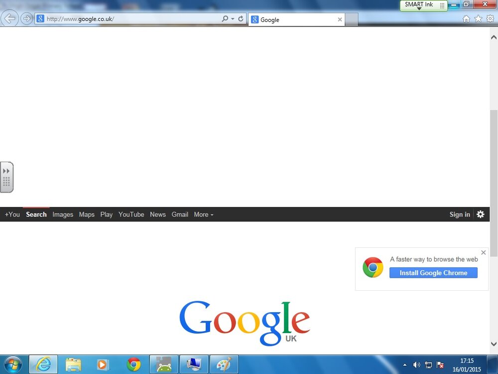

I have now seen this issue twice on 32 Bit Windows 7 PCs with IE11.

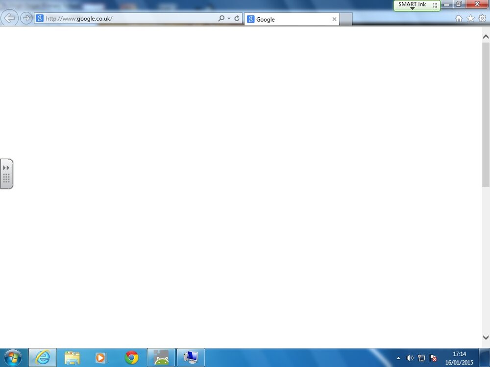

When opening IE11 the top half of the screen is blank and you have to scroll down to view Google. When clicking in the search box anything you type does not appear. Also seems to affect other websites too.
I have tried doing a rest inside IE and it does not fix the problem.
Apart from a rebuild, does anyone have any ideas how to fix this please?

I work for an educational brain break company (GoNoodle) and we've had a bunch of teachers report issues with the page being scrolled down, not being able to type in inputs, etc.
We are now able to reproduce the problem using a Windows 8 laptop and a Smart board, running SmartInk. We've actually narrowed down the problem to the fact that SmartInk inserts an additional body tag as well as a hidden form input that acts as an interceptor between what you type and Internet Explorer. Unfortunately the implementation of that input is entirely broken.
