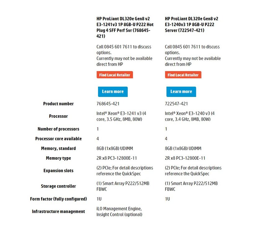

Based on a V2 being the one for me (as I can accommodate it) would the left hand system on the attached screenshot be the better server? Processor appears to be a little better.

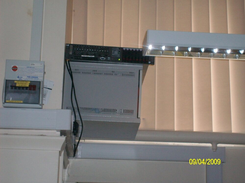

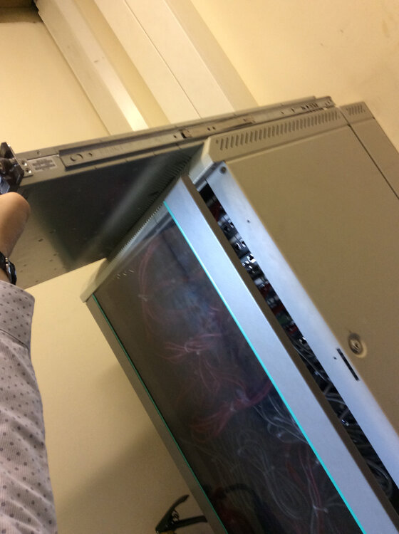

If the cab you are looking at put it in is on a wall check its actually secured correctly, I'm sure I recall @Gatt having fun with a cab starting to come from a wall with servers on top of it or something along those lines many moons ago

You really wouldn't notice the difference, but yes, the one on the left has the slightly updated model of the same CPU.
