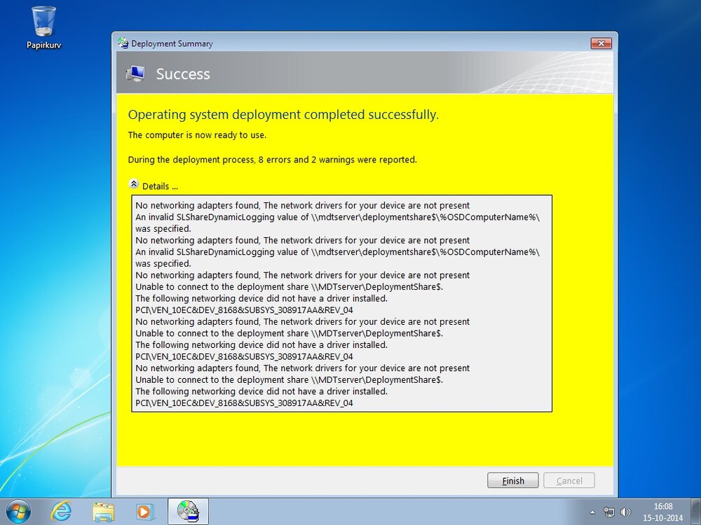

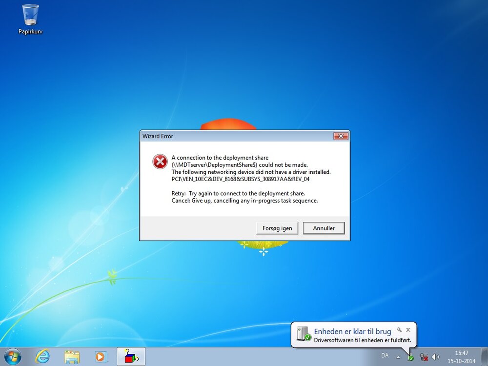

I'm suddenly getting this driver error.jpgerror during deployment.
I't seems that I have all the rigth drivers in mdt, but I'm still getting this error.
When I install the NIC driver directly into the OS, and i reboot the computer the deployment will finish, but with errors.
This is the NIC driver I'm using.

I'm not sure which drive this is is.
Pci\ven_10EC&DEV_8168&SUBSYS_308917AA&REV_04
when i google it i'm not getting anything use full. (that could just be me not being able to read pci\ven........ correctly)

When I try to deploy a Lenovo M78 I get a
"A connection to the deployment share
(xxxxxxxxxxx....) could not be made.
No networking devices were found on this machine!"
And it only happens to the M78, not to other Lenovo computers.
So how do I force a NIC driver on to my USB stick (which I use for booting) that fits the M78.
