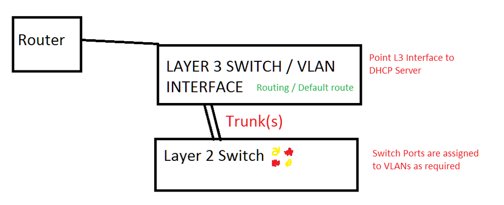

Your layer 3 switch will create a 'VLAN interface' which is how the VLAN gets routed out of - this will also be the default gateway for devices in that VLAN. This interface can point to a DHCP Server and acts like a proxy - you can set the scope for DHCP on your Server and point the interface to it.
Diagram attached
Edited by Muz

The endpoint ports, ie. the ones the devices connect to, are set (in HP nomenclature) to "untagged" in the VLAN which the machine is supposed to be connecting. The "trunks" are tagged with each and every VLAN which the link is supposed to carry.
So, when a client is connected up, it sends its DHCP request via your switch. Because the traffic is "untagged", the switch adds the applicable VLAN into the packet. That packet is then sent via the trunk and routed on the L3 switch to the correct destination, using the IP address for that VLAN interface, which the DHCP server uses to determine which scope to issue an address from.

I'll give an example of my setup. We have about a dozen VLANs. The core switch has all 12 set up, each with its own IP address. The ports going to the edge switches (trunks) have every VLAN tagged on them. The edge switches have those VLANs defined (no IP on them, just the basic details), with the "trunk"/uplink port tagged on every VLAN.
Each endpoint port then is untagged in whichever VLAN it is supposed to be working with (they aren't really, as I have a more complex setup than that but for this example they are).

The differentiation is where on your switch, you mark Port1 as untagged in VLAN1 and Port2 as untagged in VLAN2 (for example). "Untagged" is a specific term.
To clarify - in simple terms, the term "untagged" does not mean "not tagged"
Unless you are setting up something like MAC address based authentication, yes, you have to specify which VLAN each port is on.
It looks to me like Netgear use the same terminology.

(in simple terms) The switch port is configured to a specific VLAN which passes packets to whichever tagged trunk port, which then passes the tagged packets (down whichever trunk) to the L3 switch which routes it to the relevant DHCP scope (with an IP helper in place).
If I swap the cables around it'll pick up the other IP address cos the other port is configured for another VLAN.
