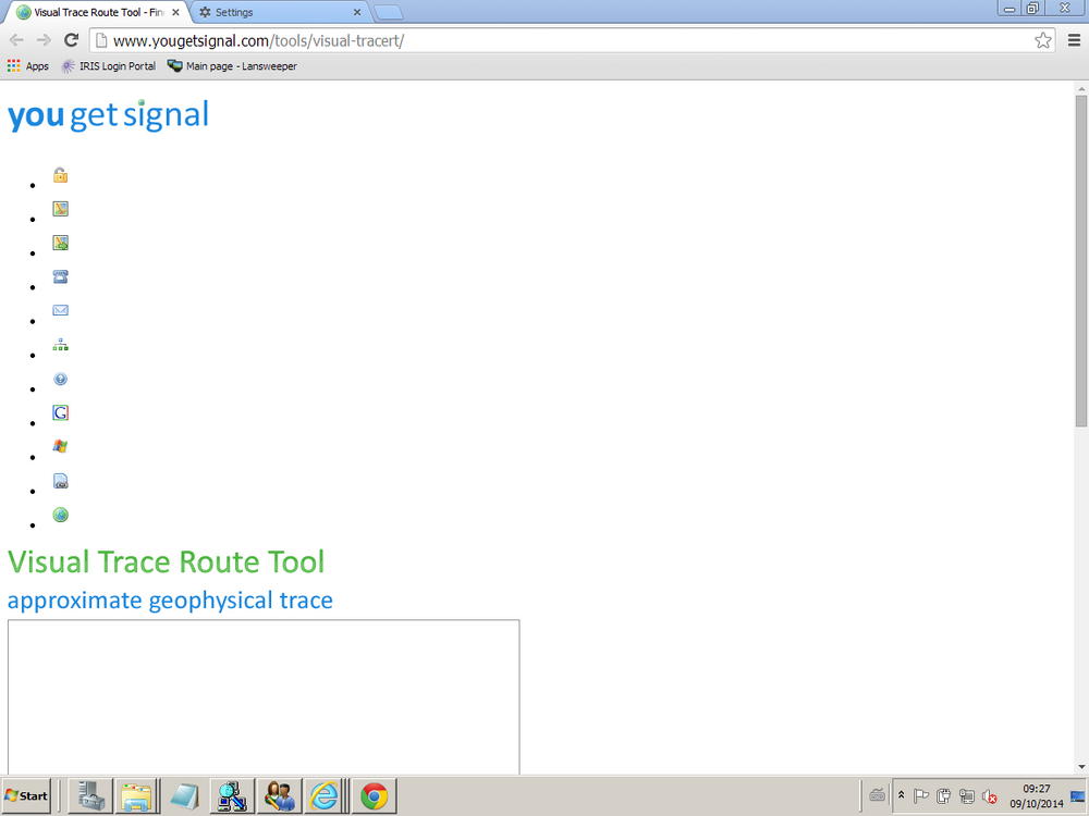

Something is 'breaking' a website, java? Flash? How can I tell what the problem is?
The Computing teacher wants the students to use this website to see how the internet works.
Visual Trace Route Tool - Find, Track, and Map the Route to an IP Address
When I try it on my mac, it works great, but when we try it on a students account the website doesn't load correctly.
I've upgraded Java and tried reducing the security to medium but it isn't helping.
As I'm not sure what it causing the problem, I don't know what to do to fix it.

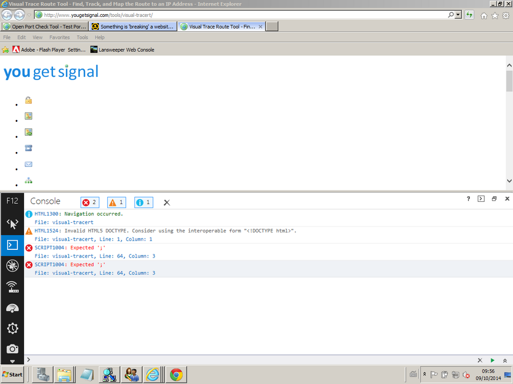

Hmm... That's what I get in IE. The site still works though in that browser.

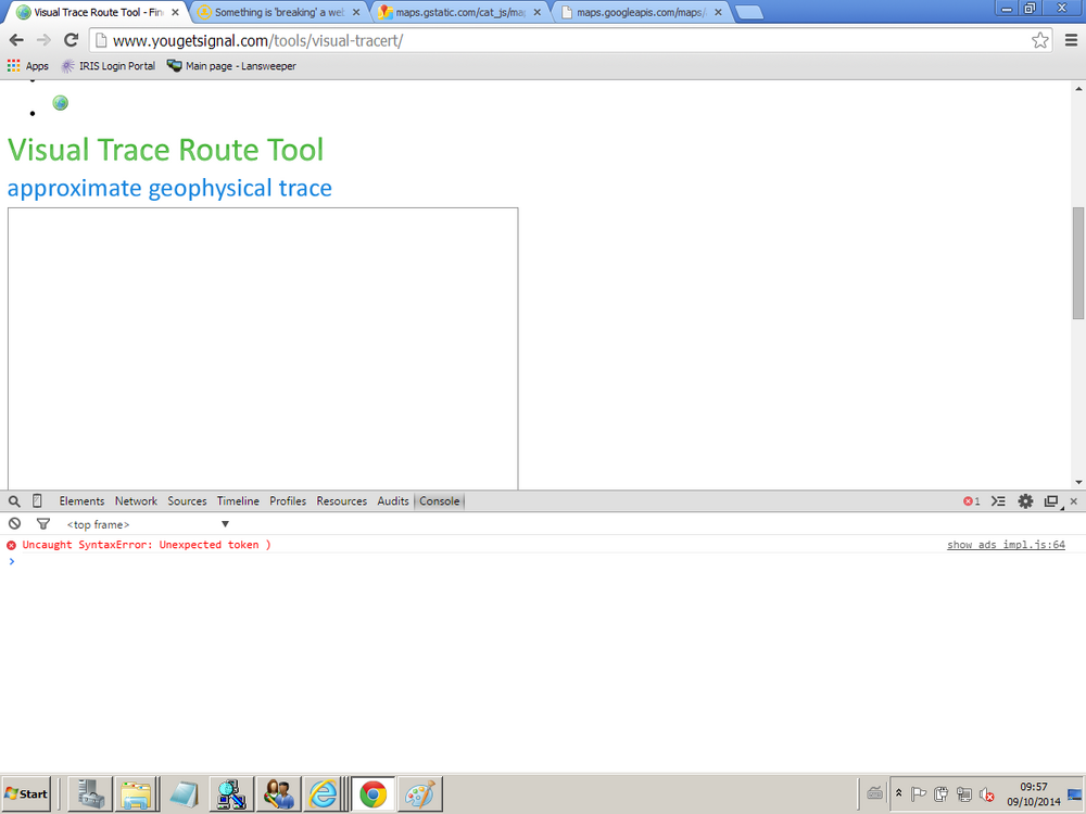

Not sure at all what could be causing this then. My suggestion, load up the inspection tool by pressing F12, go to Console and see if there are any errors.
I've tried that in both IE and Chrome, and they both have error messages. But to me, they look like coding errors so I don't understand how the website sometimes works.

I suggest checking the developer tools' network tab while the page loads on the working and non working accounts, and see if there's something that's being blocked on the student accounts.
Thanks for all your help, I haven't quite got to the bottom of it, but it is something being blocked as if I connect without going through our proxy server then it is working fine.
Is it one particular browser that's doing this? Reason I ask is because once upon a time we had a website problem like you describe. We were using IE everywhere. The website in question was downloading a control from either Facebook or Twitter and getting blocked by the proxy. IE was then going 'lol no' and refused to render the rest of the page. Chrome and Firefox both rendered the page quite happily without the blocked control. It may be worth sticking Chrome on a machine and seeing if that behaves any better.
We found this out by using the IE dev tools and running a network trace.
