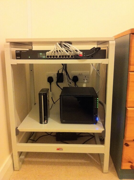

I put 2 x Cat 6 into all rooms bar my office (x8) and then had a small 6u cab in the Utility Room. An old 3com 2829 switch, NAS and all works well. Plus I have the SKy/Virig lines run in to the Cab so when I switch its easy (I also have all sat cales running in to it)
