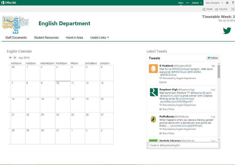

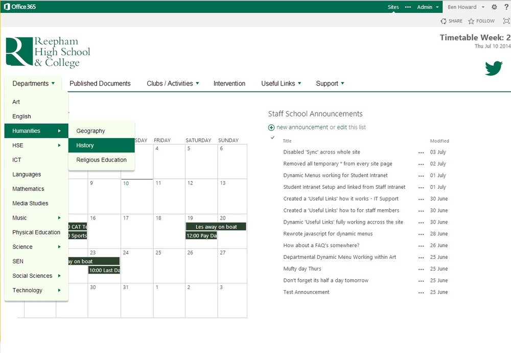

We've just started using Sharepoint 2013 and created a custom intranet page for staff / students... its only been rolled out to a few people so far but it looks promising. We have specific areas for staff / students documents along with hand in areas and resources. Each department has a its own page with a calendar and Twitter feed to try and make it more interactive for everyone... a simple design is the key I think.
Its a steep learning curve but we'll see how worthwhile it is when it goes fully live in September.
