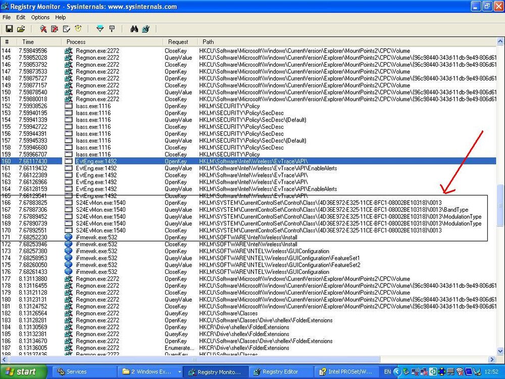

yep my thoughts exactly. I did use AutoIt3 window spy (Autohotkey) to try and pick up the scancode, but it dosent pick it up. great fun.

s24evmon.exe is an application that gives access to your wireless network interface devices configurations and diagnostics. This program is a non-essential system process, but should not be terminated unless suspected to be causing problems.
Well I'd say try it and see as that description says about access to it's configuration so looks like pressing fn + f11 uses that program to send a command to the card to turn its radio off.
If the radio is allready off and you kill s24evmon.exe then you won't be able to turn it on.
Otherwise can you leverage s24evmon.exe yourself and run a startup script or something to use it to turn the wireless on?
