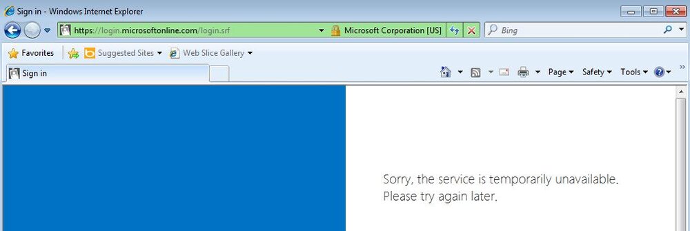

Make sure you have P2P turned off on your Lightspeed box, I am now getting the following error when users try and access out o365 SharePoint;
If you retry the SharePoint link again it allows you through.....
[ATTACH=CONFIG]21439[/ATTACH]
I'm seeing that too actually if I use mail.ourdomain.com. If I go to the proper login page it works.
