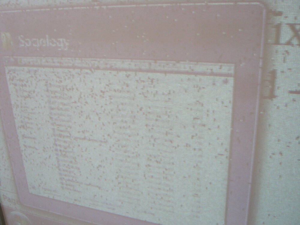

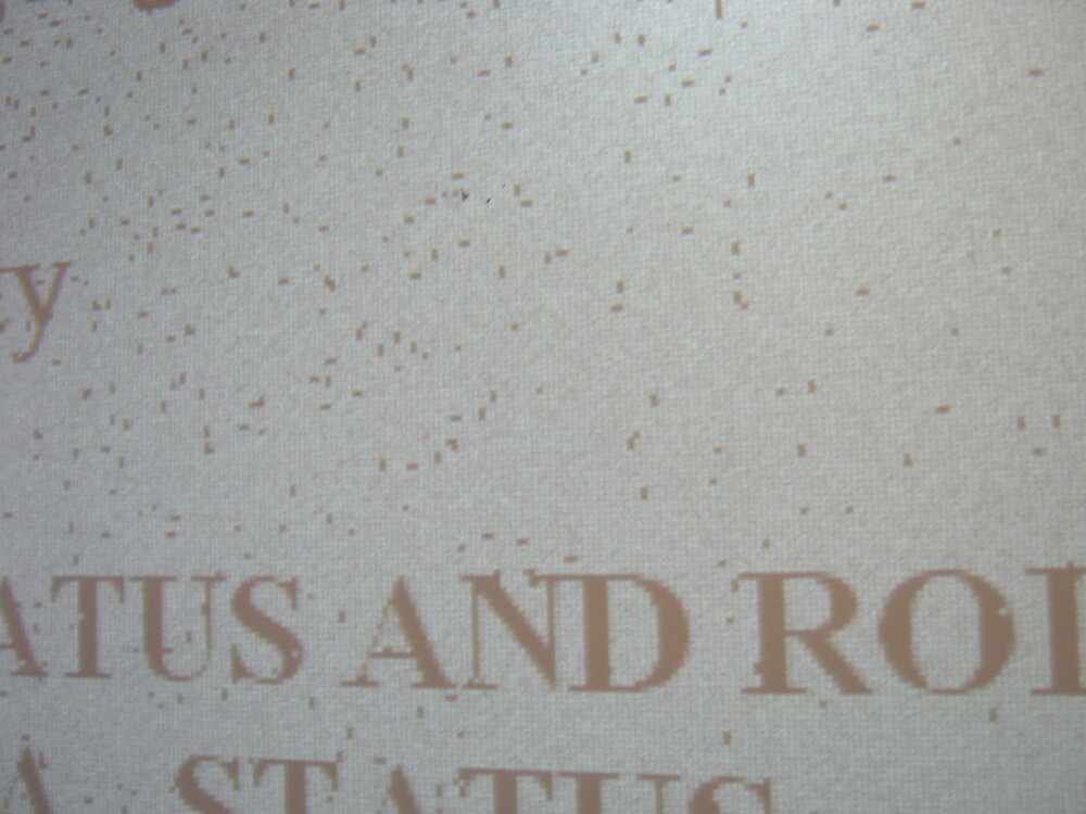

I'm thinking not likely, but any fixes for this? corrupt image with dodgy pixels all over the place as in photo attachments.
Discontinued unit & warranty expired, and limited scope to replace (quickly anyway) due to bespoke boom arm.
Id look on ebay, normally a couple on there but they are pricy even when they are used.Man, that does look bad. If you get a second unit, you can open that one up & see if there are any loose cables etc.

Looks like you've got a faulty DMD chip so the only option would be to replace the projector. SMART's UF70 fits on the same fixings at the wall end (the 3 middle ones of the 5 fixings on the UF55) so swappong the boom arm should be fairly straightforward (as long as the UF55 was fitted in the correct position!)
