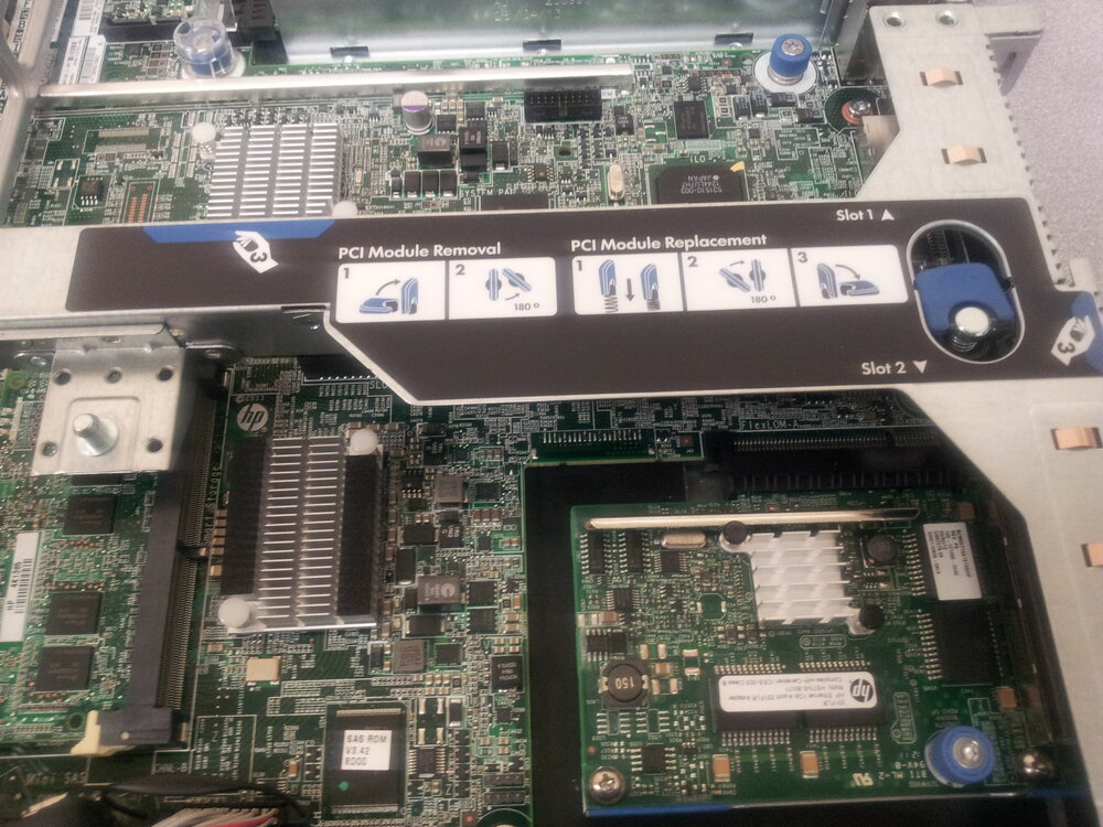

Installing on an SD?
NO SD option on that server, will try a USB stick perhaps.....? If not, it will have to go straight onto the HDs.

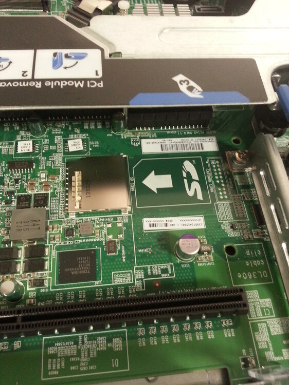

The DL360 Gen8s we've bought recently have the SD slot? next to the PCI riser.
[ATTACH=CONFIG]20058[/ATTACH]

I would be very surprised if it doesn't have a SD slot i have seen it either next to PCI riser to behind the PSU's.
With regards to come with 4 x 1Gb connections I think its the dl360e's which come with that whereas dl360p's come with the new card. Although it might be some models which come with 4 x 1gb.
They do have an SD Slot as we were a bit eek! as we needed it to, its behind the PSUs on the P model and where the FlexLOM card is on the E's :) So lots of SD goodness for everyone :)
