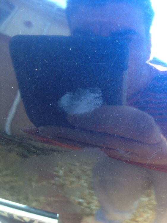

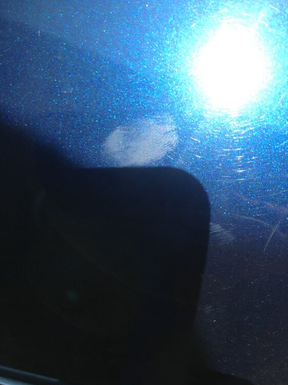

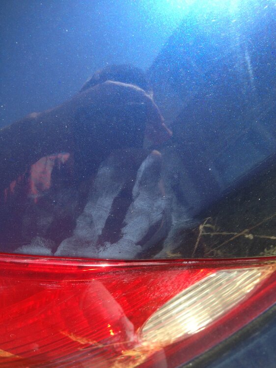

Ive already washed and T cut my car last week and am not sure but I only noticed them after taking my car to a garage a few months back after they sprayed and sorted my rear bumper out. Although I honestly cant recall if they were there prior to the work being done or if its me with the hot weather however I've used my car inc boot etc and there aren't any other marks like that on the boot
Long story short
1.) what can I do to get rid of the marks?
2.) would it be worth while asking the garage or just sort it out myself ?
Thanks
That's weird finger marks. Tcut should take the top layer off so is it under the lacquer
Finger print yourself and see if its your print
Edited by round2it
How do I do that. No ink ?
How can I get rid of them ?
Edited by mac_shinobi

That is suncream.
You will probably find that the marks belong to you or your nearest and dearest.
You will also have sod all chance of them ever going fully.
The particle size of suncream gets between the paint polymers.
Tcut and all the rest do make a difference for a while and with repeated effort you may get somewhere eventually.
Sorry to bear bad news.
BoX
That is suncream.
BoX

Mechanic friend had a bottle of old tcut which got rid of it and used my newer t cut to get the colour back up for now as can't afford anything else at the min
Ha, I have those all over the car. The most annoying ones were actually in the lexan headlamp lenses! It is indeed suncream. I dealt with the headlights by using a machine polisher and cutting compound - the lenses were faded badly anyway. Not any more! :)
