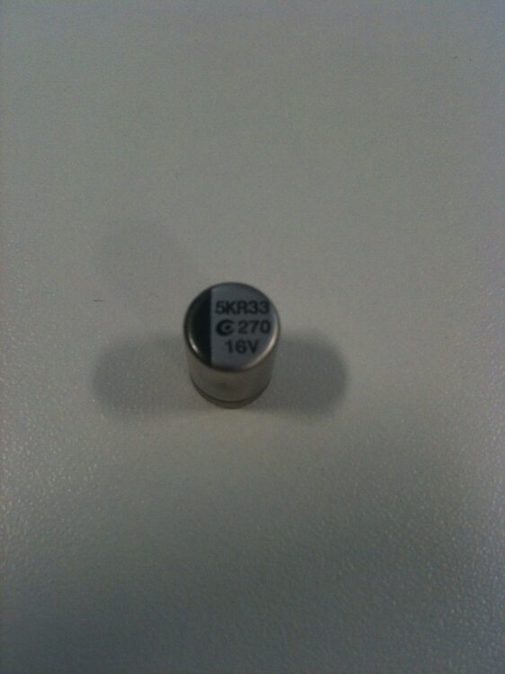

mole Posted July 17, 2013 Report Posted July 17, 2013 Morning I have a graphics card with a bust capacitor and i need to replace it, but am unsure as to what capacitor I require. On the top of it it says: 5KR33 270 16V it came from a Asus HD Radeon 512mb Silent. Hopefully i've managed to attach a photo of it
chazzy2501 Posted July 17, 2013 Report Posted July 17, 2013 (edited) anything on the side? I guess from that picture would be a 270 µF 16volt Cap EDIT: electrolytic! cap remember the polarity.. EDITX2: the cap doesn't look burst how did you determine it's failed? I have a posh multi-meter with a cap tester on it that can tell me it's capacity. Otherwise I'd test resistance and watch it climb but that would only tell me that it was not ruined not underperforming. Edited July 17, 2013 by chazzy2501 1
mole Posted July 17, 2013 Author Report Posted July 17, 2013 thanks, no nothing on the side. - i take it the 5KR33 doesn't have any bearing on it? it took a knock and has fallen off and + and - prongs came out of the capacitor. thanks for your input
LosOjos Posted July 17, 2013 Report Posted July 17, 2013 (edited) I'm with @chazzy2501 - 270 @ 16v by the looks of it... only way to be certain would be to test the capacitance with a multimeter - even though the legs have broken off you should still be able to see the ends of them enough to make contact. Failing that, pick up a pack of these and try one out (preferably testing the card afterwards on an old/unwanted mobo first, just in case!): Buy Aluminium Capacitors with next day delivery | RS Components EDIT: although they're a bit dearer, I'd go for the Nichicon for the longer lifespan - don't want to shove in a cheap one only to have to replace it in a couple of months time Edited July 17, 2013 by LosOjos 1
mole Posted July 18, 2013 Author Report Posted July 18, 2013 So soldered on another capacitor, a 220 and higher voltage but it works fine.
