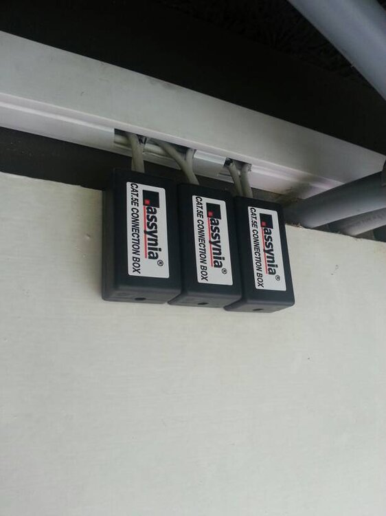

Hi Guys,
During the Half term couple of the network cables been cut by the onsite building constructors. but they but a joint box anf sixed the problem. after this two class toom pcs not getting the Dynamic IP from the DHCP. when i dis check the ipconfig / all it shows Nod type as Paired. but rest of the computers in school shows as Hybrid, What are these. what is Paired or hybrid. is this caused the problem?
The junction boxes are fine to use but over longer distances they may not be quite up to the job.
When our building expansion goes ahead we have asked for complete new runs.
I have to admit, never seen anything like that myself either. To me the problem's seriously over engineered. You're just as well to expose the copper and wrap it with security tape in the short term. At least then it would fit back into the existing trunking and workstations can connect properly with DHCP.
There's nothing wrong with those boxes - they are designed just for that purpose, but you really need a network cable tester to make sure they are ok from end to end and connected correctly. There is the possibility of more than one break or the cable run might simply be too long.
I'm thinking the same. I'm getting someone to check it tomorrow.
I'd have to disagree. This is UTP copper, and the more you expose and untwist the pairs, the more crosstalk you introduce. Cat5e was not meant to be spliced. In addition they've installed them incorrectly by feeding both ends through the same side of the box - they're designed to have one end come in each side.
