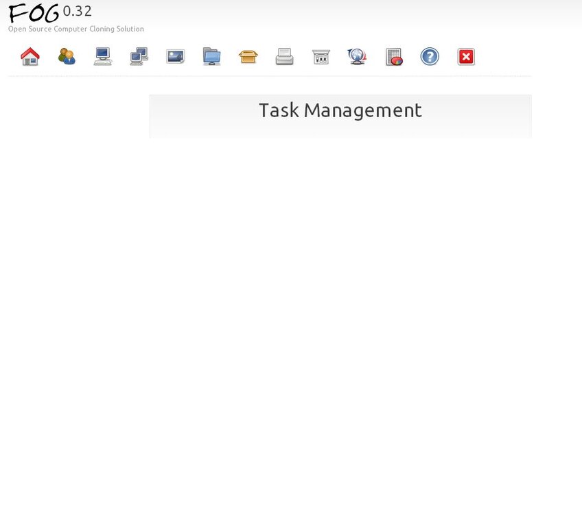

Anyone get a blank page with Task Management at the top with nothing else there?
Im trying to capture a image with the panel but i get that? Or am i doing it wrong again?

I had this too - below worked
Newer versions of PHP no longer accept function calls with arguments explicitly passed by reference. It's been deprecated for several releases of PHP, but still worked. It does not work anymore. The function definition must specify whether the argument is passed by value or by reference, and the function call just needs to specify the variable name or value without the &
gksu gedit /var/www/fog/management/includes/tasks.confirm.include.php
Search Menu > Replace
Search for: &$tmp
Replace with: $tmp
Replace All (there were somewhere around twenty instances)
Save
Close
Then try to schedule your upload task again.
