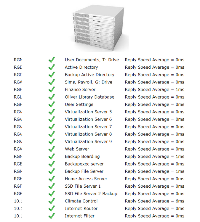

fairm010 Posted April 16, 2013 Author Report Posted April 16, 2013 Right! After some headbanging and HTML lessons ive knocked this up! Its a combination of both Zag's code and Sonofsantas code. I think its quite good! [ATTACH=CONFIG]17833[/ATTACH] Tell me what you think! Matt
zag Posted April 17, 2013 Report Posted April 17, 2013 @zag Ive got that setup and working. Does it refresh automatically? If a server was to go down would it pick it up straight away or would a refresh be needed? No its doesn't refresh automatically, but someone posted some code in the original thread to do that. Looks great
fairm010 Posted April 17, 2013 Author Report Posted April 17, 2013 Thanks Zag, I've already put some in. Thanks for the great bit of code!!
