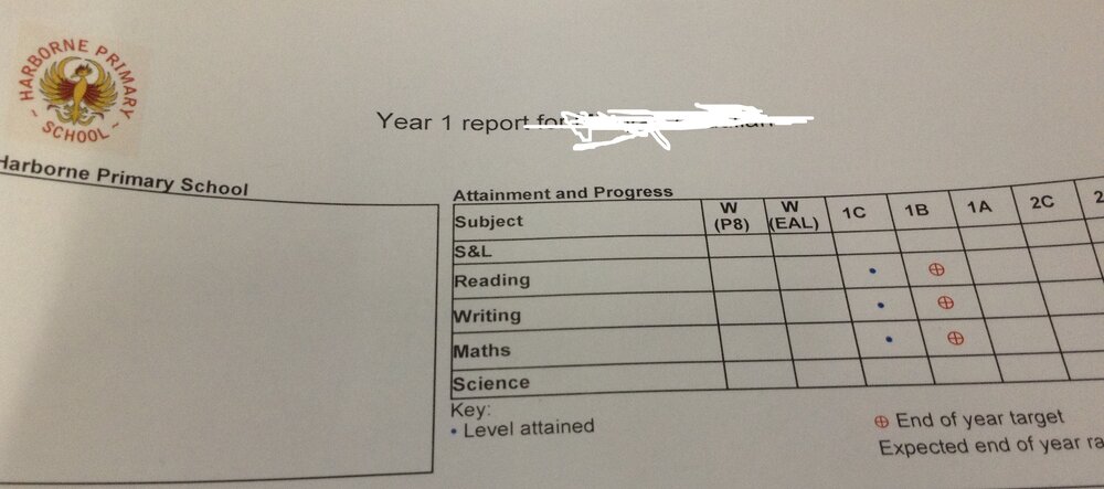

Ok, so staff are trying to print reports using Target Tracker.
The report has some colour coding in it. We seem to be having an issue with the green. Some printers are printing the green and some are ignoring it completely.
The printers are installed on a server and then dished out via a script, i've compared the drivers in the properties of a working printer and a non working and they are the same.
The printers print green otherwise quite happily...any thoughts?

Is it all colours that are getting stripped out, or just green?
Expected:
[ATTACH=CONFIG]17294[/ATTACH]
Reality:
[ATTACH=CONFIG]17295[/ATTACH]
Yeah... I'm going to go ahead and diagnose this as "Aliens".
It's probably Target Tracker creating print jobs in a weird way...
Have you contacted Target Tracker about this issue? maybe its a bug in their software that only happens under certain conditions.
