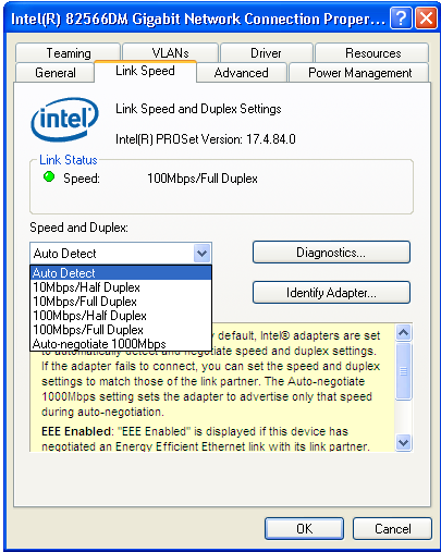

GTX Posted February 12, 2013 Author Report Posted February 12, 2013 networkspeed.bmp This is what i get Steve.
DMcCoy Posted February 12, 2013 Report Posted February 12, 2013 82566DM 100MB Auto-Negotiation with 16.4 and 16.5
Michael Posted February 12, 2013 Report Posted February 12, 2013 It's definitely a gigabit adapter. Try selecting Auto-negotiate 1000Mbps. I presume also that your switches are configured to auto 1000 and not force 1000. It does make a difference.
GTX Posted February 12, 2013 Author Report Posted February 12, 2013 82566DM 100MB Auto-Negotiation with 16.4 and 16.5 Sadly that didnt work I did do a test on the line from the NIC and it said the cable is good, This is really getting on my boobs now -.-
