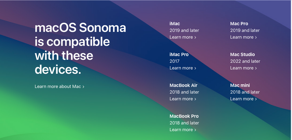

"No, I mean 2012" Can't see how? I've had a mid-2012 MBP from new and I can only run macOS Catalina as later OS are not supported (or even installable) on that hardware. Not that it matters but I would look at what you've got closely and think again. I think the solution you ended up using is probably the best for your situation. If you don't have a large-ish Mac estate I wouldn't bother with ARD as it does it have its quirks which can make it difficult to use. Good luck.
"MacOS Sonoma on a 2012 MBP . . . " Perhaps you meant 2021 MBP? I would go Brimstone's suggestion which is ideal for remotely controlling and managing to some degree Macs in a local network. Does not respond too well if you've a segmented network although it's easy to get round the limitation. Obviously you're better doing this Mac to Mac. Other alternatives are CoRD which you could look at. TBH ARD is probably the way to go.
