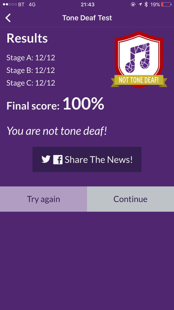

ToneDeafTest.com - Find Out If You Are Tone Deaf Or Not
MartinRouterKing replied to 6Foot2's topic in Links
