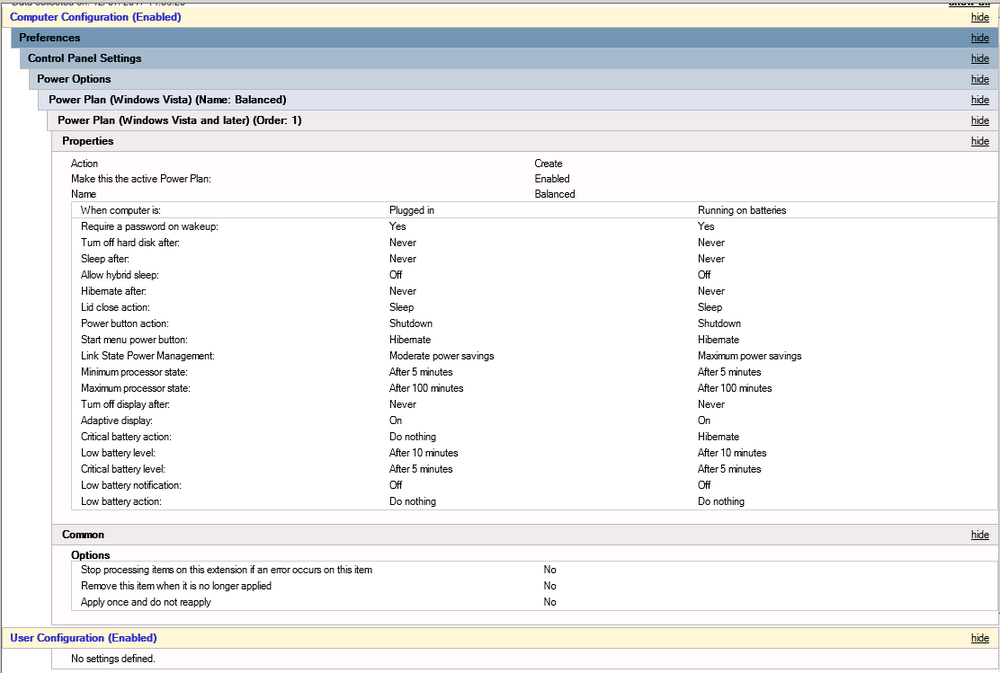

Computer>Policies>Admin Templates>System>Power Management - Worked perfect, thanks!! -

Thanks all. @QuertyMash - Yes, all fine apart from this one. @LeMarchand - I've tried rsop.msc and checked out the policies there but it's not showing. Think I'll try the alternative path as you suggest and feedback tomorrow. I'm not doing overtime for nobody -
Hi all, I've created a GPO with the settings detailed in the screenshot below. I've applied the GPO to the respective OU, done a gpupdate but the machines don't seem to be pulling down the policy, and thus are going to sleep all the time. I've tried it at computer level and user level. Server 2008R2 / W7. How do you all control the power settings? I'm considering a third party option for this, and hopefully it might help with the powering on and off, of the machines too.
