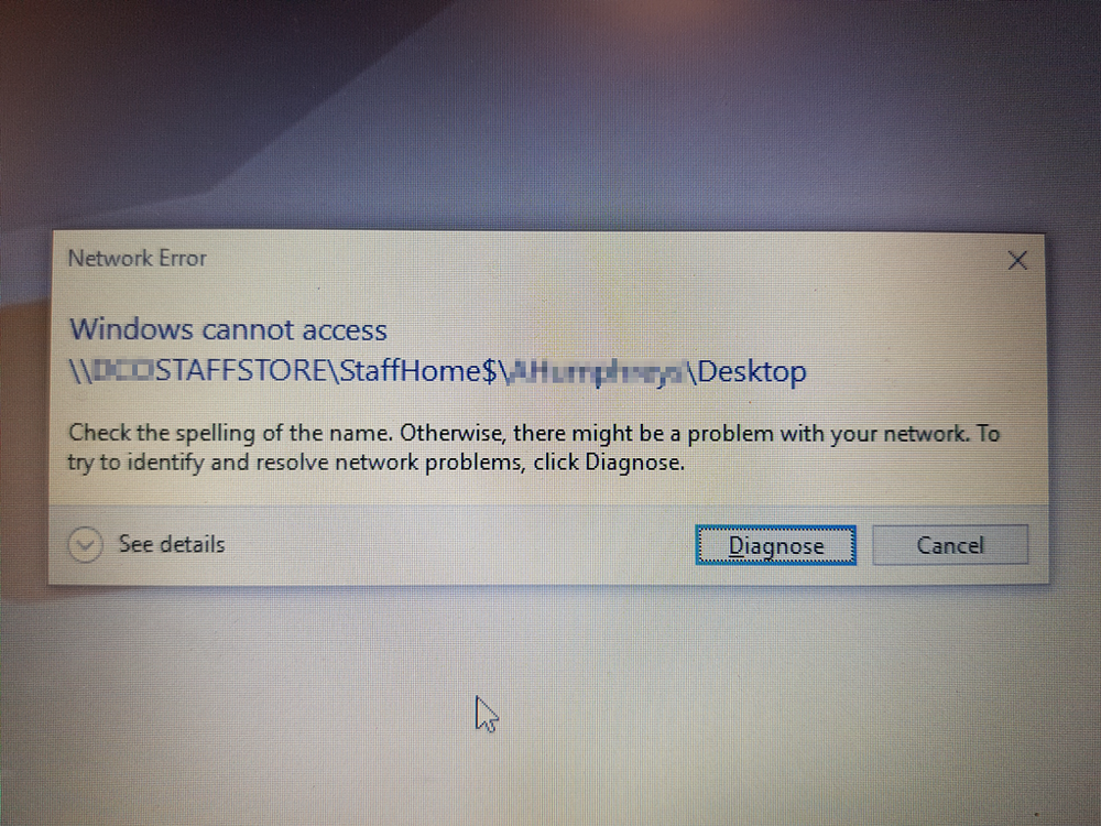

40 Excellent
About manamaga2512

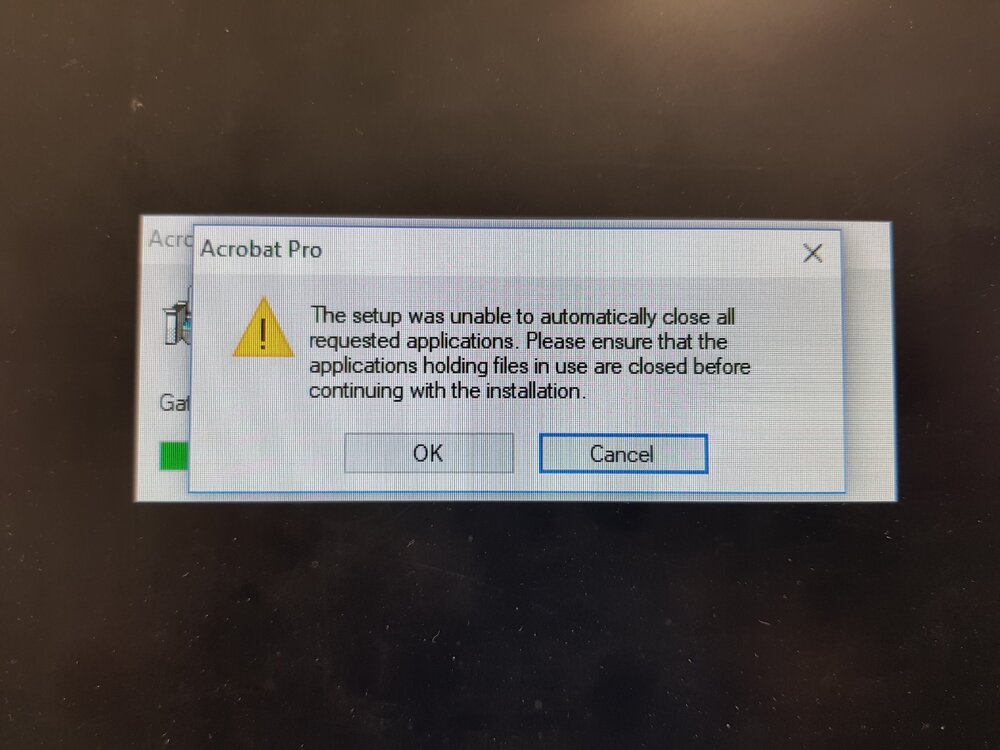

  3. Hi all, using Adobe Creative Cloud Packager I've just successfully built the msi package required to install Acrobat Pro. When running the install on my machine I'm asked to close Windows Explorer (I've read that this is normal), but what happens after my desktop goes black is that I get this error: At which point clicking OK or Cancel both result in the dialog boxes closing and my desktop staying black, and me having to refresh windows explorer in task manager in order to restore my desktop. Any ideas please? Many thanks.

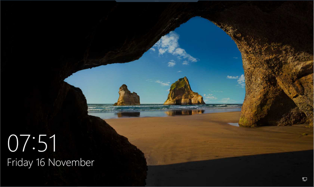

  7. Quick update on this. Done all the above but still machines are not at the logon screen. I have got the correct GPO setting haven't I? The machines are sat at this screen: And in order to prompt the login username / password fields, we have to CTRL+ALT+DEL or hit any key.
