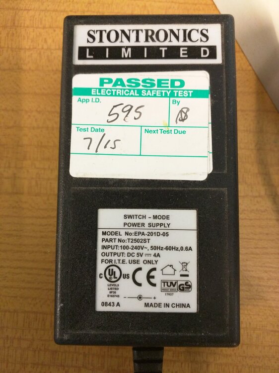

  20. Thanks. I guess I'm older than most on here so feel quite embarrassed that I couldn't identify it myself - I've never really had need to use them before. Right - can anyone now identify this strange contraption ;-)

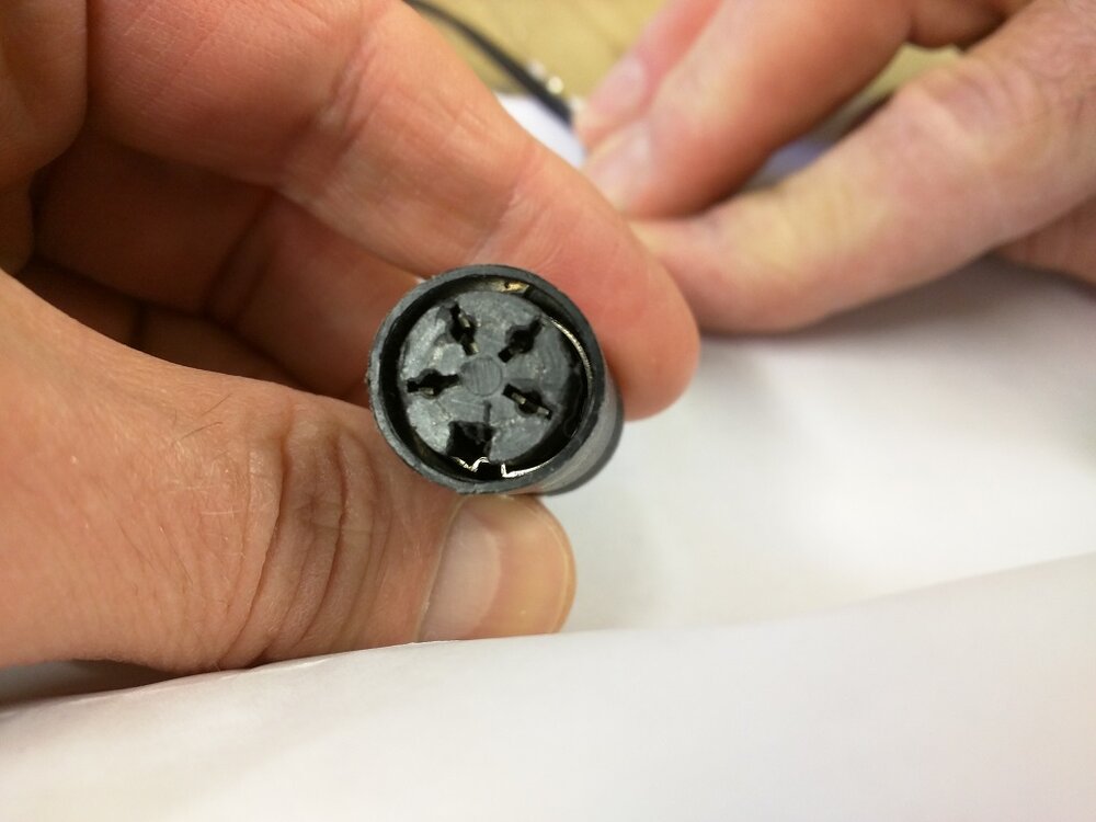

  21. Brilliant - I hardly had time to blink before you answered it - so thanks very much @localzuk. @themightymrp - it's from a trickle charger adapter.
  22. Hi all, Can anyone please help identify the name of this connector type? Specifically, I need a male counterpart adapter (which has gone missing) that attaches to it and I just want to make sure that I order the correct part. Many thanks
