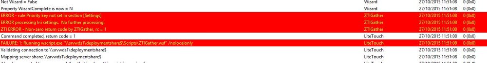

Hoping someone can help me out. For weeks now I have had OS deployments working seamlessly, yesterday I wanted to add a rule in based on the TaskSequenceID, which I already have some in place anyway but each time I edit the customsettings.ini it just seems to stop processing. I get an error of: ERROR - rule Priority key no set in section [settings] ERROR processing Ini settings. No further processing ZTI Error - Non-zero return code by ztigather, rc = 1 Event 41002 sent: ZTI ERROR - Non-zero return code by ztigather, rc = 1 Below is my customsettings.ini: [settings] Priority=TaskSequenceID, SendMail, Default Properties=MyCustomProperty,OSDSendMailFrom,OSDSendMailToPri,OSDSendMailToSec,OSDSendMailSMTPServer,OSDSendMailIncludeBDDLog [001] SkipCapture=Yes [002] SkipCature=No SkipDomainMembership=yes SkipApplications=Yes BackupShare=\\server\deploymentshare$\Captures [003] DomainAdmin=user DomainAdminPassword=Password DomainAdminDomain=domain JoinDomain=domain SkipCapture=YES [004] SkipCature=Yes [005] DomainAdmin=user DomainAdminPassword=Password DomainAdminDomain=domain JoinDomain=domain SkipCapture=YES [Default] OSInstall=Y _SMSTSORGNAME=School Image Deployment SkipAdminPassword=Yes SkipProductKey=Yes SkipBDDWelcome=Yes SkipApplications=No SkipComputerBackup=YES SkipBitLocker=YES SkipDeploymentType=Yes SkipDomainMembership=No SkipPackageDisplay=Yes SkipUserData=Yes SkipWizard=No SkipSummary=No SkipFinalSummary=No SkipTimeZone=Yes SkipLocaleSelection=Yes WSUSServer=http://server:8530 UserDataLocation=None FinishAction=Restart AdminPassword= Countrycode=44 TimeZone=085 TimeZoneName=GMT Standard Time UILanguage=en-GB UILanguagefallback=0809:00000809 KeyboardLocale=0809:00000809 UserLocale=en-GB InputLocale=0809:00000809 SystemLocale=0809:00000809 BitsPerPel=32 VRefresh=60 XResolution=1 YResolution=1 EventService=http://server:9800 [sendMail] OSDSendMailFrom=OS_Deployment@domain OSDSendMailToPri=%UserID%@domain OSDSendMailToSec=user@domain OSDSendMailSMTPServer=xx.xx.xx.xx OSDSendMailIncludeBDDLog=YES SLShareDynamicLogging=\\server\Logs$ If I attempt to change the ini file back to what it was, i.e. removing [005] then it still doesn't work. Fortunately, I'm working off snapshots at the moment whilst I'm trying to get this working so it isn't too much bother to revert back. I'd be interested to know if anyone else has come up against something similar.

Found a work around to this: https://social.technet.microsoft.com/Forums/en-US/84831d92-b69a-493b-8dc8-3e0efb419242/tasksequenceid-not-being-set-trying-to-use-for-customsettingsini-sub-sections?forum=mdt Essentially it's not running ZTIGather following the TS selection. I have edited the DeployWiz_SelectTS.vbs as mentioned in the above link, it does seem to work though there is one minor flaw in that if you select one TS and then want to go back and select another it retains the settings from the first TS you selected.
Yep did that first, though I think I read somewhere it shouldn't matter for the customsettings.ini but I always update it if something doesn't seem to have taken effect.
Just trialling this out now. It all looks correct to me, but each time I select the 001 TS it always defaults to workgroup, also asks me to capture which leads me to think it's maybe not applying the customsettings.ini correctly. [settings] Priority=TaskSequenceID,Default Properties=MyCustomProperty [Default] OSInstall=Y _SMSTSORGNAME=School Name SkipAdminPassword=Yes SkipProductKey=Yes SkipBDDWelcome=Yes SkipBitLocker=YES SkipDeploymentType=Yes SkipComputerBackup=YES SkipPackageDisplay=Yes SkipUserData=Yes SkipWizard=No SkipSummary=Yes SkipFinalSummary=No SkipTimeZone=Yes SkipLocaleSelection=Yes WSUSServer=http://SRVWSUS:8530 UserDataLocation=None FinishAction=Restart AdminPassword= SkipDomainMembership=No Countrycode=44 TimeZone=085 TimeZoneName=GMT Standard Time UILanguage=en-GB UILanguagefallback=0809:00000809 KeyboardLocale=0809:00000809 UserLocale=en-GB InputLocale=0809:00000809 SystemLocale=0809:00000809 BitsPerPel=32 VRefresh=60 XResolution=1 YResolution=1 [001] JoinDomain=domain DomainAdmin=Deployment DomainAdminPassword= DomainAdminDomain=domain SkipApplications=No SkipCapture=YES
