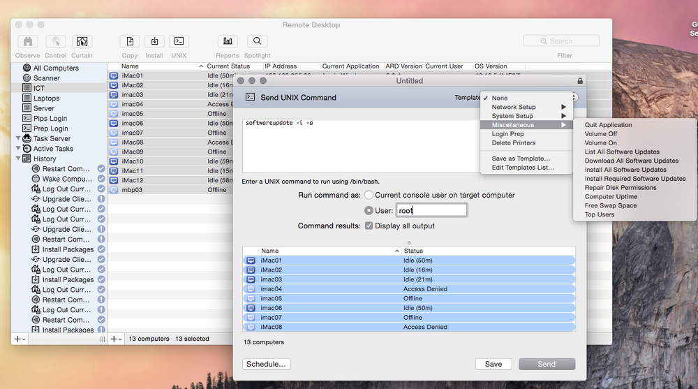

  19. 1 and 2 there are 'easy' with remote desktop. 1. Select the computer(s) -> Click on Unix -> Templates -> Miscellaneous -> Install All Software Updates There are some other update commands there you can try out. 2. Select computer(s) -> Click Install and then drag drop your package (.pkg) file and click Install. This does require the install/update to be in packages form but I have yet to have an app/driver I couldn't get a package for. This is of course making the big assumption that Remote Desktop is setup to allow you to interact with the client computers

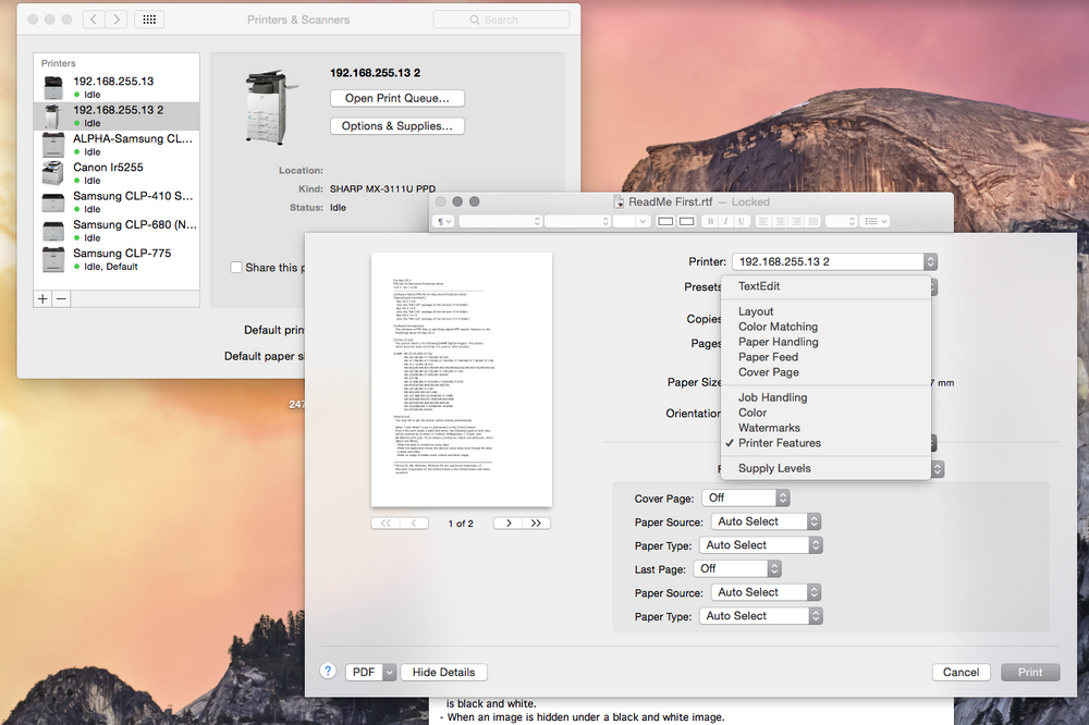

  20. I just installed the PPD driver and then added a random network printer. I seem to get all the options. Can you post a picture of you print dialog? This is mine below. Is yours a network printer and how are you adding it?
