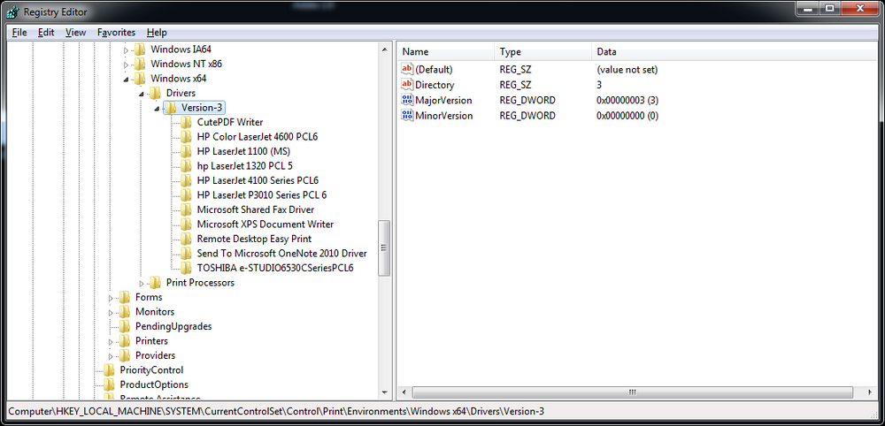

The driver itself might be borked. Does this printer successfully install on other laptops running the same version and architecture of Windows on problem machine? Also, deleting the drivers folder inside the spool directory does not completely remove the driver. Remove the printer, stop the spool service, delete the driver's registry key and restart the spool service. When you go to reinstall the printer Windows will copy a fresh copy of the driver from the print server. The key under environments will change depending on the architecture of Windows you're running.
