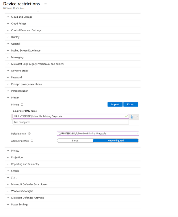

  17. Two options off top of my head if either fits your needs: My go to but involves fiddling with drivers: This guide has a nice how-to about packaging printers in Win32 apps with an install and uninstall script - used it successfully many times without issue. https://msendpointmgr.com/2022/01/03/install-network-printers-intune-win32apps-powershell/ Device restrictions > Printers Under the device restrictions configuration profile you can specify domain printers to be added - only used it once so can't give it a solid review but seemed to work without issue
