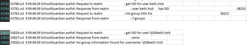

  21. We have an issue with radius certification on Smoothwall at the moment for our BYOD wifi. Our newer Macbook users cant seem to get connected via PEAP, but other users are seemingly still able. When going through the smoothwall logs I found something interesting.. it looks like AD correctly returns authentication for the user, but then 20 seconds later another request is sent; but with what looks like an escape character in front of it? Surely this isnt normal? Its the only user in the entire log for the morning that this occurs to. If anyone with more experience of smoothwall has any ideas I would be greatful to hear. Thanks for your time! B
