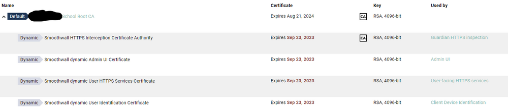

  7. I have the solution for this. Create a new root ca. Set the new one as default. Set the old as default - this will renew the dynamic certs. Delete the new root CA as it's no longer needed.
  8. Do I even need to bother if the Root CA isn't actually expiring? Will the dynamic ones renew themselves?
  9. Hi there, I am getting this message on the Smoothwall at this site: - The Guardian CA certificate will expire in 24 days. Click the button below to find out how to regenerate the certificate The show me how to guide, basically, just says do it. So, anyway, I can create a New Root CA, although the Root CA hasn't expired? Then I can download it, and push it out via GPO, and Workspace. How do I generate the ones labelled as Dynamic? Or do they self generate and that's why they are dynamic?
