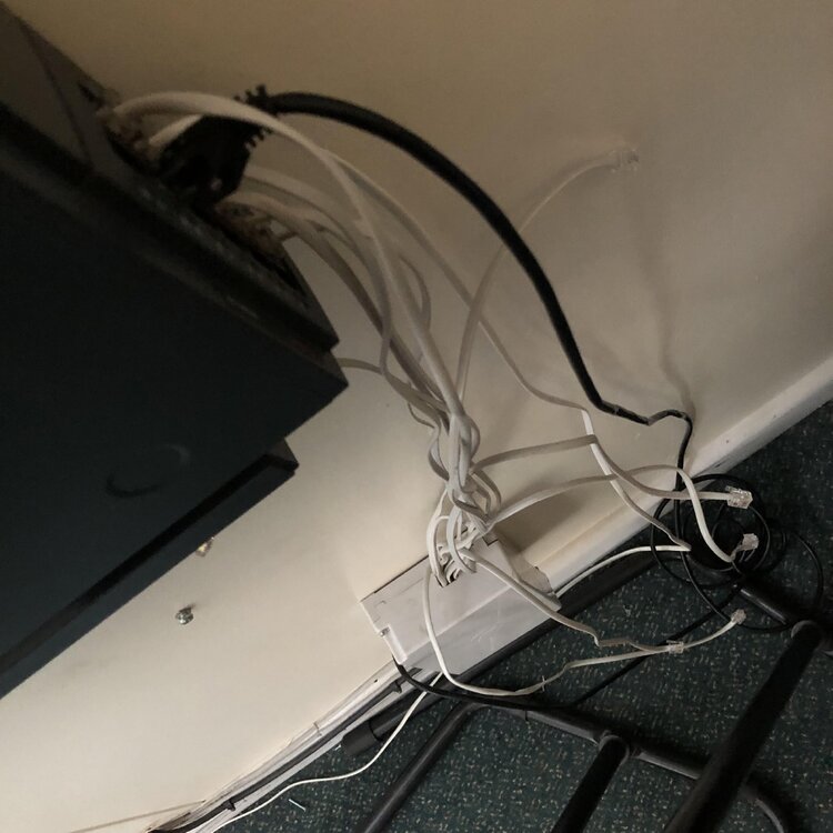

So....we recently took over IT support for a local primary school over from another company, little did the school realise the looking after the phone system that was supplied by a 3rd party vendor was not included, so they had a power cut and since then the phone system has been down and they have no support or maintenance contract with the previous company and have asked us to take a initial look at it (Long story for another time)... They are running a PBX (Avaya IP 500V2) I am no entirely sure why the numbers are like that with top row showing 1-2 3-4 etc and bottom row showing 1 on top of 2 and 3 on top of 4 ??? Not familiar at all with these units The Way it is connected is as follows 1) A Phone cable going from the BT Open Reach Socket to Port 9?? on the switch (See Red X mark on the image) 2) Then there is another RJ45 Cable going from the Port above which i assume is port 9? (Blue X mark on the image) and this goes down to the floor in a box with a bunch of analogue cables 3) Then on the PBX control unit itself at the back of the box there is a cable that links back to the switches which is all fine 4) Bottom Row (Black X) there is a bunch of Phone cables connected to it see second image on the thread Does this seem like the correct setup does anyone know? Someone (Possibly from the school) have been disconnecting and reconnecting cables so have absolutely no idea what has been done and what goes where Thought i'd check here incase anyone has any knowledge as we have never dealt with phone system before Probably going to end up getting the school to have to pay the company half day call out charge to get things right Everything interally works fine switches/and software but seems to be issues making internal and external calls!
