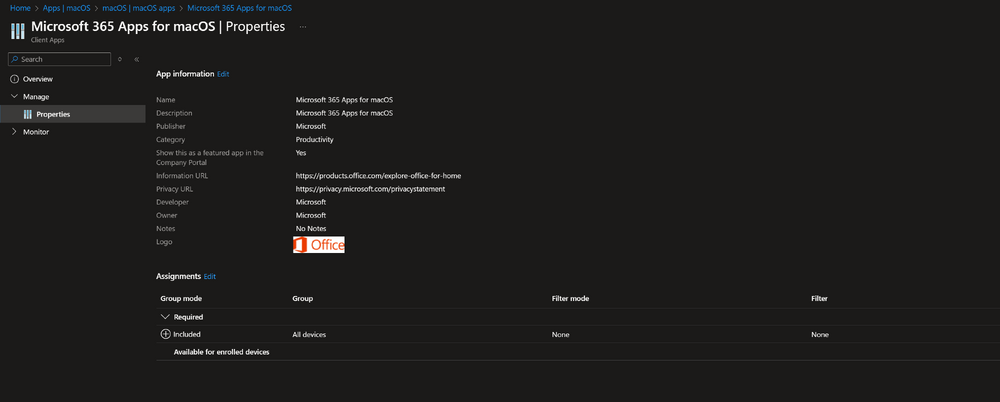

In this instance I would have strongly have thought it was intelligent enough as it was the Apps category under macOS and the app itself says Microsoft 365 for macOS. But yes I know where you are coming from with your query. Any concerns, just use the assignment option and apply it to groups defined by you. -

Not knowing your level of integration all I can say is, the ios and macos devices we use are present in Apple School Manager (ASM) either via a reseller or some devices were assigned to the ASM via Apple Configurator. Then the whole enrolment integration for ASM and Intune has been setup with Enrolment tokens / push certificates etc. So for installing Microsoft 365 apps it was just a case of assigning the bult in app profile to all devices, or you could target it to a specific AAD Group: -

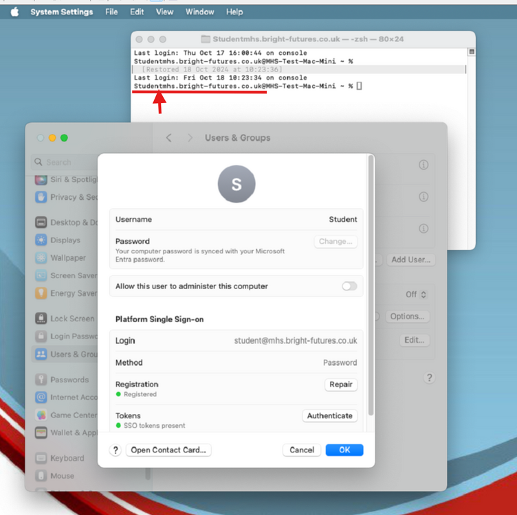

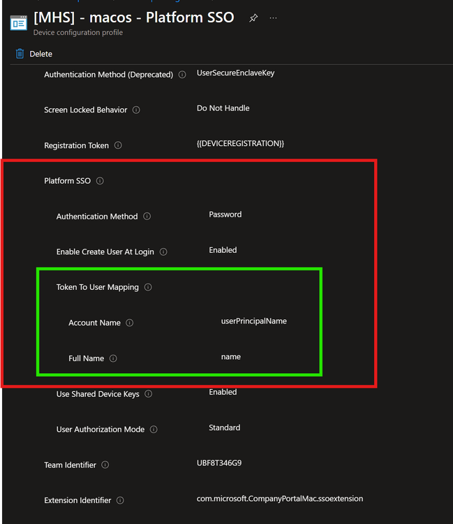

Hey all, Ok, so managed the basics fine, I've configured a macOS device to be enrolled into Intune successfully fairly straight forward. I'm able to log onto the device with a Microsoft 365 email account. The problem I am having is meeting the requirements set out by the school. For Windows devices I am able to add a domain prefix so when logging in we only have to enter the samaccountname (Username) i.e. "Student" rather than the full UPN [email protected] Anyone made this work? Next issue is, the Token To User Mapping. I cant seem to find any other values or variables that could be used in the Account Name. Only option provided in documentation is userPrincipalName. Yet the local account created on the macOS ends up being the email address (almost). The Display name is Student but the account name becomes studentmhs.bright-futures.co.uk. It misses out the "@" because a macOS local account cant include an "@" This becomes a problem because I have a SMB share shortcut configured on the Dock but it prepopulates the username field with studentmhs.bright-futures.co.uk so having to manually enter in the "@". I noticed if I just enter "Student" the share works. So ideally I need a new variable in the Token to User Mapping that creates the local macOS account as just the Username and not the full UPN. Hopefully that would kill two birds with one stone with the domain prefix also just being the username and not the full UPN. Thoughts anyone? Thanks

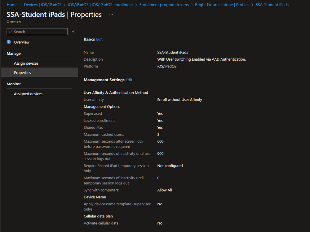

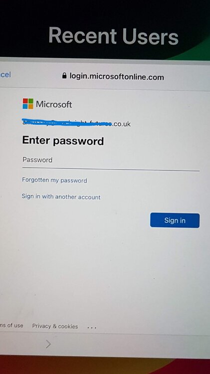

Quick update, had a slight wobble on Friday evening re-enrolling the iPads to pick up the new profile. When you log in as a guest only user, you only get allocated 2GB of Guest storage. This wasn't enough for the assigned apps to install into. However it seems to have managed to deploy over the weekend successfully. You can either sign out and sign back in to gain the 2gb of storage again, or it might be the apps continue to push out and install whilst the device is on the lock screen / sleep.

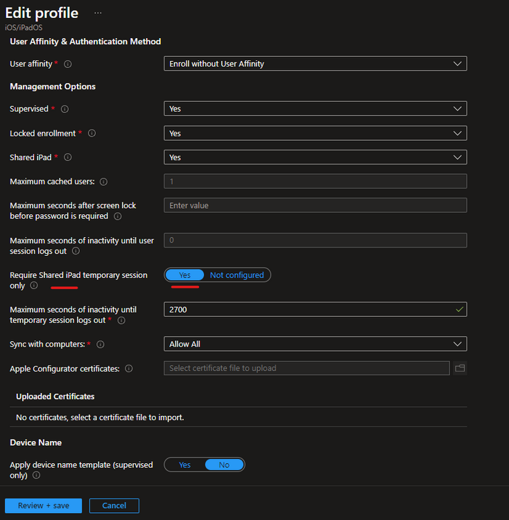

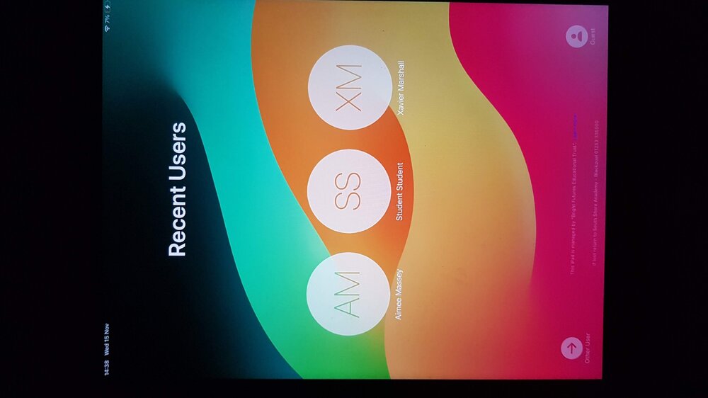

So after spending the day testing etc. I settled on using the Temporary Session Option. This way the device when powered on is in Guest Mode. They reach the homepage, and all published apps such as MS Teams are already present and they just sign in with their email credentials. Then either after a timeout or the next person picks up the device they sign in with guest mode and in testing, Apps like MS Teams prompt for logon again which resolves the initial issue I was having of credentials being too persistent between classes. Also when logging in as guest, there is no Language/Location or Pin setup screen prompts, just straight in.

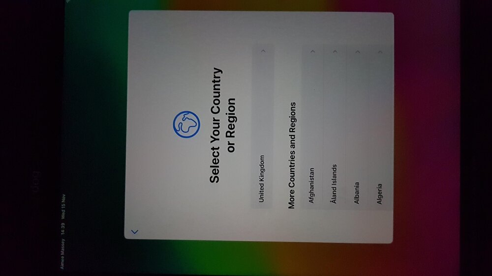

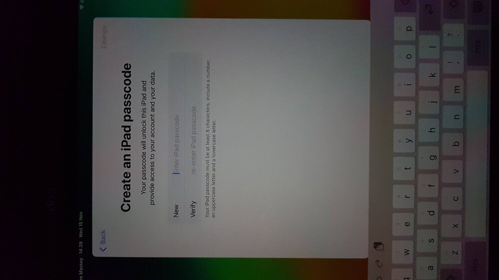

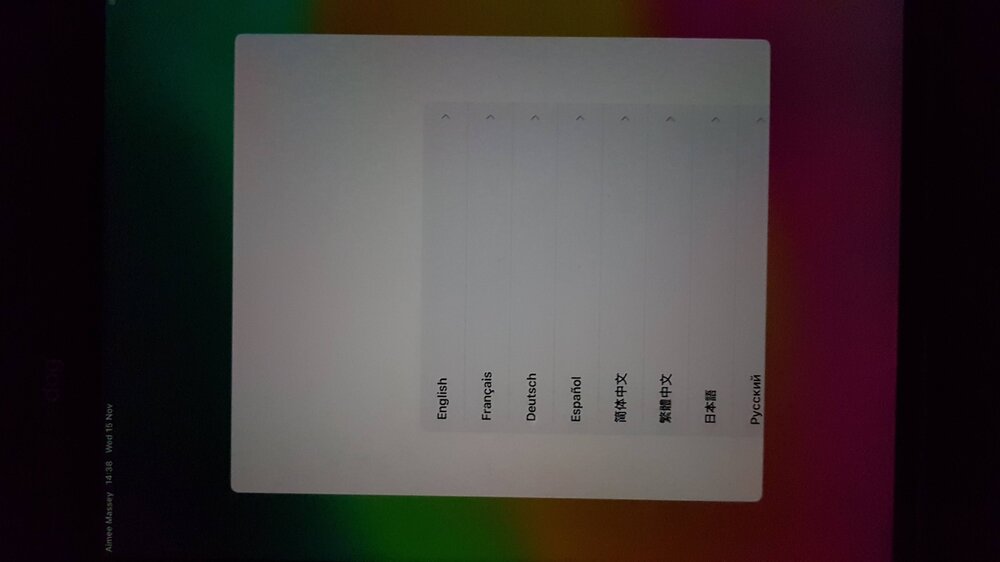

Afternoon, For reasons, I've decided to try and configure the iPads that are enrolled into Intune Endpoint Manager to have user accounts via Azure AAD. This is all now setup with federated domain within Apple School Manager. My last hurdle it seems is, each new logon to a device, first askes for your email/password (thats great), but then the setup assistant kicks in and asks for Language/Location and to setup a PIN. If nothing else, I want to suppress the PIN requirement. See attached screenshots. Has anyone any experience with Shared iPads in Schools using user profiles on Intune MDM?

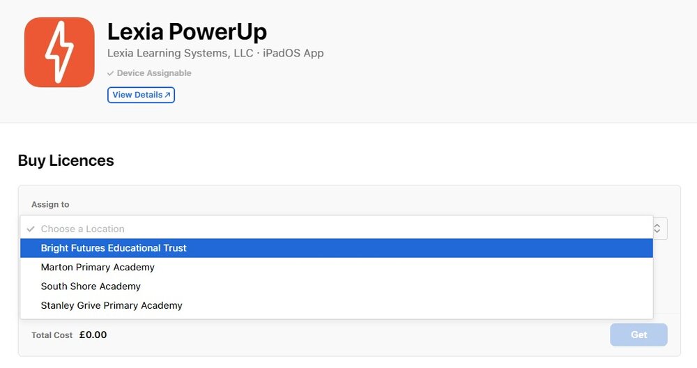

Good afternoon all, Can the locations feature in ASM be used in anyway with Intune Endpoint Manager? i.e. Use a central ASM but create the locations, and then somehow assign the licences to the correct groups in Endpoint Manager/Intune. I can't see anything in Intune that links to the ASM individual locations. Thanks

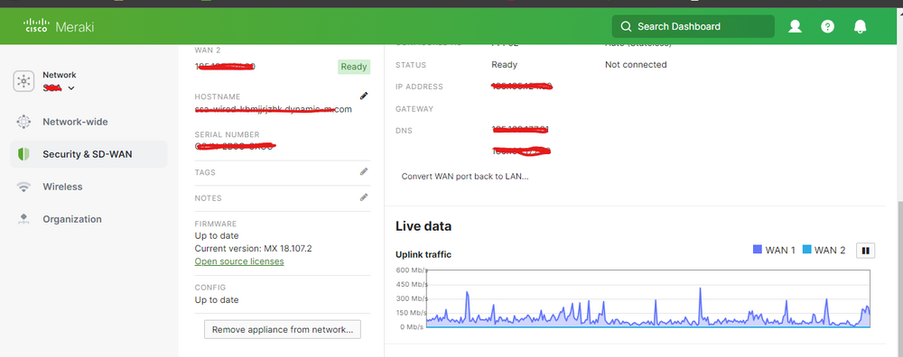

Morning all, Wondering if anyone knows of an application or a desktop widget that would pull through the Meraki Live Data Uplink traffic monitor for an Appliance. Rather than having the webpage open which then times out and logs off after x amount of minutes. Would just like to keep a closer eye on it for awhile. thanks in advance.
