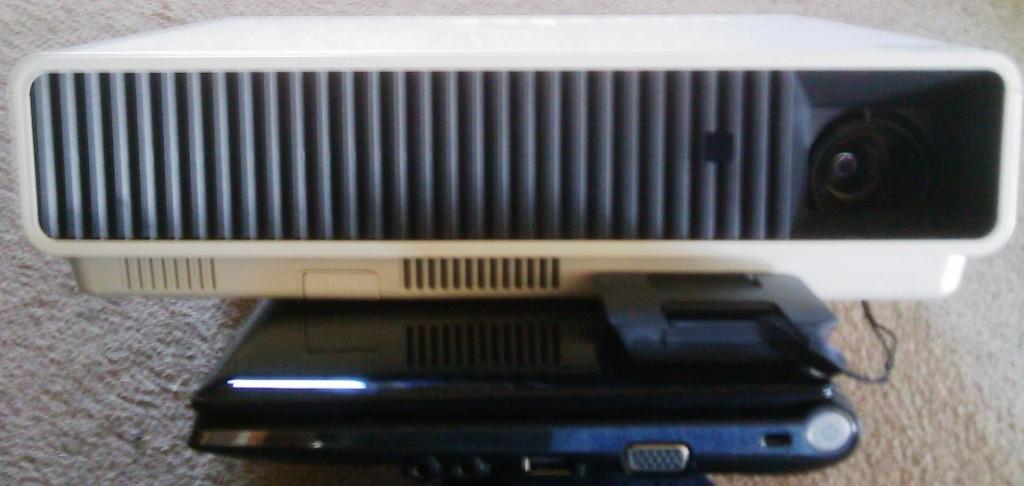

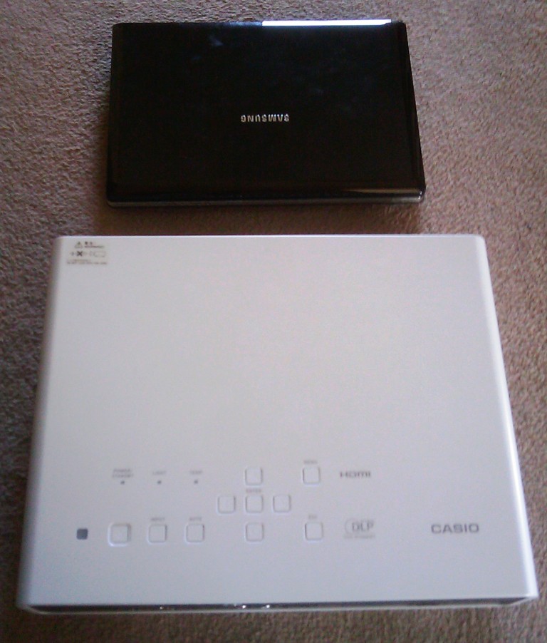

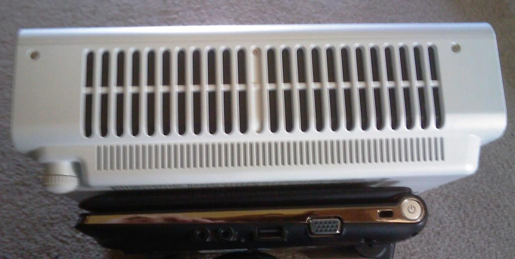

So down to the in-depth part of the M Range. I ordered an XJ-M130, which is the direct equivalent of the XJ-A130, so it's a 2000 lumens general purpose projector without USB or Wifi connectivity, it arrived the next day from my local AV Supplier, and instantly I was shocked by the size of the box and weight of it, I nearly dropped it and its shipping handle failed as I picked it up that was the first thing that brought me to thinking this is different, packaging is the same style as the previous model, but inside I found the first major change, this new unit is a beast, with beast being an understatement as its HUGE!

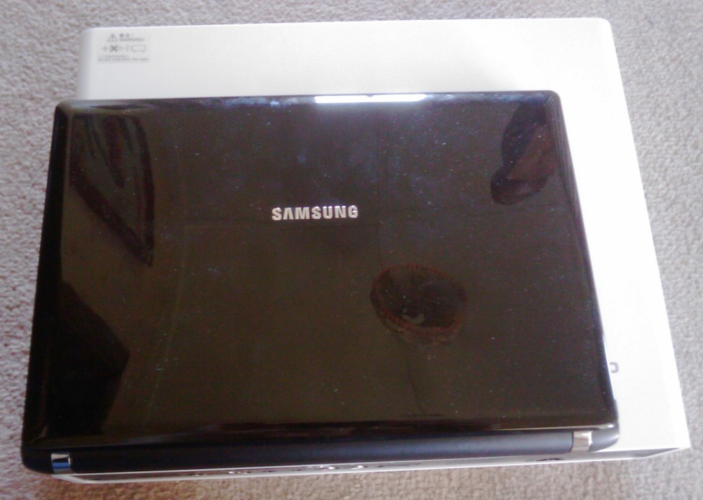

As you can see from these photos, when comparing the unit to a Samsung NC10 Netbook which was a similar thickness to the A range, you begin to get a scale for the new model. Its got the larger fans in it, which has made it silent unlike its previous generation which was noisy in certain modes, so that's a bonus, it's also got a larger number of vents to let the airflow better, it still has no end-user cleanable filters which is a blessing for us.

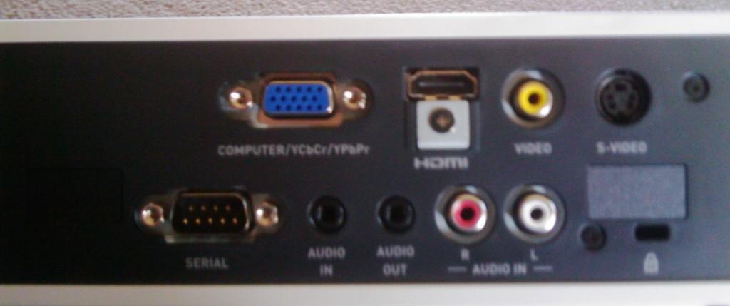

In-use it's no different to the previous model apart from its silent operation, the menus are identically setup and styled, the on-off works the same as the last generation and the remote looks the same, although its bright white this time, the rear panel now has a more standard range of connections that other brands of projector have:
I personally am thankful for this expanded range as the old 3 way cable for AV connections was a mistake as they got lost and often when replacing old projectors required barrel connectors to join the AV leads together as traditionally you had a female socket on the projector, but the A series presented a set of male ends which was a bit of an annoyance.

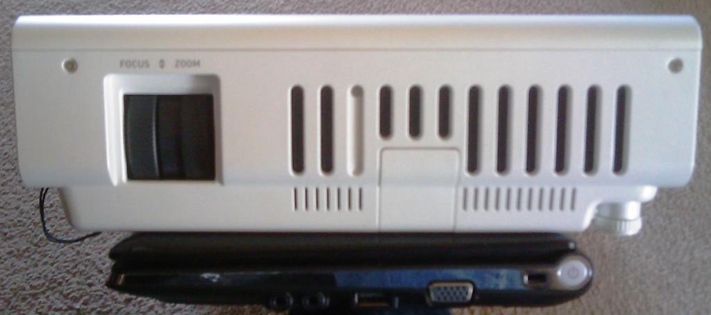

Zoom and focus are now easily accessed via wheels on the edge of the projector, again more like a traditional unit
However when I placed it on-top of an A130 which is set for a Smartboard and connected it in-place and set the zoom to maximum I was only filling about 70% of the board compared to the A130 in that room covering about 90% of the board so the brilliant zoom and optics which were a major selling point in the A series have reduced slightly, however they are still very impressive.
