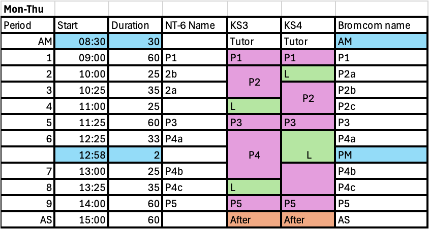

This is how our period structure ended up looking (our TT was made in NT6 and then pulled in to Bromcom) and is slightly more convuluted than it may otherwise have been owing to some of the information our timetabler was given by the NT6 team not quite being compatible with the way Bromcom works (a timetable is in chronological order, and must run sequentially)
