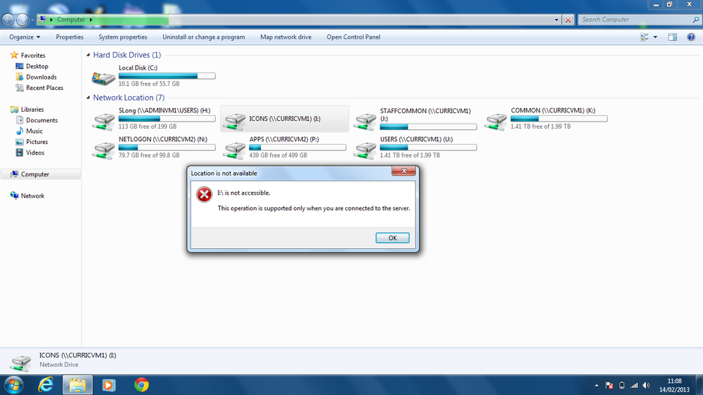

Hey I'm having the same problems only this time is a about 20 out of 30 laptops windows 64bit,
So far the test I have ran are:
If student or teacher logs onto the laptop they cannot get desktop icons or startup menu or sometimes access to there Home drive
If the same users logs on to a classroom Windows 7 64bit PC its all good
On the laptops If I the admin logs on I cannot get access to the redirected Icons folder
I get an error message "this operation is supported only when you are connected to the server"
however I have tried with a LAN and wireless connection. still the same issues.
but If I log in to a classroom PC I can get access to the Icons and start up.
